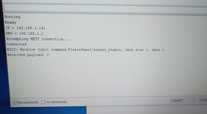

Hi
i am new to working with Arduino and c/++
but i am working on a small project that uses MQTT
i have setup a test MQTT server on the lan, and i can see the connection attempt from the Arduino device, but the result is:
failed, rc=-2
I can use other client's against the same MQTT broker, so i know that it's working.
if I try to use hostname for the MQTT server instead connecting from the Arduino, the connection is not established at all and i can not see the connection attempt on the broker.
Using hostname from other computers on the LAN works
i am using DHCP to assign IP to the Arduino, it's a mega rev3 with ethernet shield 2
network connection is stable, testing with icmp from another computer on the lan.
i have read many forum and blog post's but have yet to find a solution to the problem.
thanks
Can you set your MQTT server to verbose mode to get a better idea what is wrong?
it's already running in verbose mode, all its printing is:
1641314502: mosquitto version 1.6.9 starting
1641314502: Using default config.
1641314502: Opening ipv6 listen socket on port 1883.
1641314502: Opening ipv4 listen socket on port 1883.
1641314504: New connection from 192.168.1.141 on port 1883.
1641314506: New connection from 192.168.1.141 on port 1883.
1641314511: New connection from 192.168.1.141 on port 1883.
1641314516: New connection from 192.168.1.141 on port 1883.
1641314521: New connection from 192.168.1.141 on port 1883.
1641314526: New connection from 192.168.1.141 on port 1883.
1641314531: New connection from 192.168.1.141 on port 1883.
1641314536: New connection from 192.168.1.141 on port 1883.

hi, thanks!
got the working now as long as i don't set this:
   pinMode(RXen, OUTPUT);
most likely because pin4 is used by the ethernet shield for the SD-card data
so changed it to:
#define RXen 5
#define TXen 6
#define COM_VCC 7
next step, connect rest of the hardware

Hi
anyone here that can give some pointers on how to get the mqtt message in the correct format and with the correct data, looking at the code? (full code in previous post.)
#define TOPSZ 60  // Max number of characters in topic string
#define MESSZ 240 // Max number of characters in JSON message string
void mqttDataCb(char* topic, byte* data, unsigned int data_len) {

Hi
i have connected everything, but i have not managed to get it to work for yet
when the correct topic is received, the program seems to stop at this point
could be that the rest of the mqtt message that i send is not correct?
and then this led turn's on on the 485 board
i suspect something in the code, but i have not been able to figure out what it is yet
Have you used a MQTT viewer to see if the data has made it to the Broker?
Yes, your secret code could be the issue but as long as the code remains secret or it's feed out in snippets, troubleshooting the code will be near impossible. Good luck allowing others help with troubleshooting your secret code and snippet's.
yes, it's received by the broker and it's received by the Arduino, code running on the Arduino gives another error if the topic is wrong, so mqtt seems to be ok.
and when the topic is correct the 485 board is activated (led lit), but nothing else happens, and the code seems to stop, Arduino is still replying on ICMP, but does not process new messages from mqtt.
complete code is already posted in this thread. jan4.

Hello, ESP8266 or ESP32 will be much easier for MQTT related stuffs. You can get some idea from here: ESP32 MQTT - The Engineering Projects
Add some more prints in mqttDataCb so you can see what you got and where execution went.
