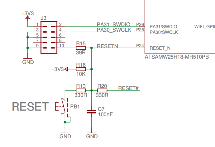

I am looking for a way to reset the MKR1000 board within in a sketch, based on a certain number of retries when a connection is lost to the WiFi. I know this seems like an odd way to solve a problem, but when I loose a WiFi connection, and I simply unplug or reset the MKR1000, I have always been reconnected to the WiFi without a problem.
I have followed and contributed to other discussions with sandeepmistry and aurora123 but so far no concrete solutions, so I thought I would try another approach.
Looking at the "pinout" on the MKR1000 schematic ... it seems that the 24th pin of the chip is the RESET_N pin. There is also a WIFI_RESET_N pin 50? Can someone suggest or explain the difference?
Could I simply put in a bit of code to sets one of those pins to low?

In looking at the schematic I do see a 330 ohm resistor inline with the reset button, and that certainly can not hurt. I am still unclear how to "label" the pin. Is it called "P24" ??? I have attached an enlarged portion of the schematic, if you don't mind looking at it.
Jim
That looks sort of familiar so just copy that from the pin you choose to use as reset with the 100 nF (C20) and the 330 Ohm (R7) resistor and you should be fine.

However, I am still not sure I am asking the question I really need to answer. For example, in a standard sketch, if I assign a variable named "ledPin" to A1 which is "analog 1" ... I am really using the third pin on the left side of the IC chip. My code would be something like:
"#define ledPin A1"
The Analog and Digital pins are pretty easy to understand ... but I want to use the "reset" pin.
The question is what "name" would I use for that pin? "reset" ???? It is actually pin 5 on J5, just as A1 is pin 3 on J4
Jim
Are you pulling pin 10 (reset) low with an IO from another pin ?
if thats the case you can define it as whatever you wish.
RST, RESET, KILLSWITCH etc.
There are two resets one on (pin 10) the jtag header and one on the regular pins (pin 10 on the schem but a regular connector also )

Have you tried them both ?
