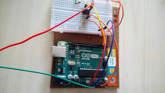

Thanks for the replies! I am attaching my wiring. Also, I have decided not to connect the LEDs until I have the msgeq7 up and running. I have read a lot about led strips and arduino, they are not going to be connected as they are in the instructable. The resistor is 220k.
Circuit diagrams are okay for diagnosis, images for beauty contests.
Where does power come from?

I have tried to power the Arduino with USB cabel and I have tried to power the Arduino with an external 12V.
The thing is that I keep getting constant 195-196 values from the MSGEQ7 with and without inputing sound.
What happens with sound?
It needs to be a biggish signal.
Also what is the code?
