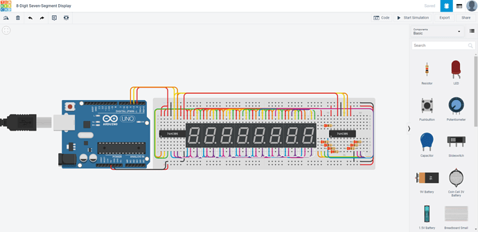

Hello. Over the last few days, I have been writing a program for a 8-digit 7-segment driven by a dual 74hc595 setup that I designed in tinkercad while attending my career technical center. The link for the project will be at the end of this post if you want a visualization of the hardware. The problem that I initially had was displaying 8 characters at a time using a for() loop that displayed the same character on every "digit" of the display. Now, despite having multiplexed the entire display with two nested for loops, iterating each individual segment through each individual digit without having any problems, when taking the "draw the whole letter then go to the next digit" approach, the display began to flicker. I figured as maybe the dual-shift register setup didnt have enough power to flicker through all 8 digits 8 segments at a time, that the solution would be to do what I originally did but only display segments if they should be displayed. However, the same flickering issue reoccurred, even though I was only displaying the segments of a single digit. I tried this program on both an Arduino Uno and and Arduino Mega with similar flickering affects. I'm hoping someone can tell me this is a simple problem with my code, and not a physical constraint of the arduino or the shift registers, as I don't have the money to buy "better" versions of either. The code seems to work in TinkerCad, so I'm stumped on this. Thanks for the help :slight_smile:

And here's the link to the TinkerCad setup:
Click me
(the link expires in 360-something hours, I can refresh it if necessary. Feel free to make changes, as I made a back-up of the file :slight_smile:
Also, here's a video of the flickering issue in slow motion, in case it helps
Click me
notmage:
Click me
Unfortunately, that appears to be a private link. :astonished:

It is not clear from the video and your wiring diagram is not visible.

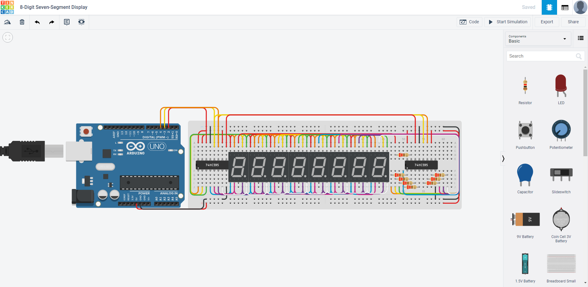

I apologize, it appears you need to have a tinkercad account in order to view my link. Below will include a .brd file (as it seems to be the only file output on tinkercad) and a screenshot of the display. Yes, I'm using 220 ohm current resistors to the ground pins, and no current resistors to the "segment" pins. I apologize if my code is confusing, I started programming with Java which is object oriented as opposed to straight forward code. The general idea of the flow of the program is as follows:

Well you were asked for a schematic and a link to that display, nether of which you have supplied, so no, still not sufficient information.
What you have supplied is a physical layout diagram who's only use is to blindly layout the components on a solder-less bread board. To an engineer that sort of thing is impossible to determine what the design is, nor if you have made any mistakes.
A .brd file is useless unless you have Tinker CAD which rules out most members here.

The multiplexing strategy is not very transparent from the fritzing diagram.
With only 3 arduino pins in use, one shift register must handle the common pins and one must handle the segment pins. The shift register which handles the segment pins should have the current limiting resistors (well, that would be usual for optimum brightness but there are other strategies). The shift register that handles the common pins should have only 1 connection to each of the 8 displays. You appear to have arbitrarily assigned half the pins of each display to 1 shift register and the other half to the other shift register. You appear also not to have considered the maximum current rating of the shift register pins. The shift register which drives the common pins must, at any given moment, power up to 8 segments (including the decimal point).
Are the displays common anode or common cathode ? what is the pinout and segment current rating ?
