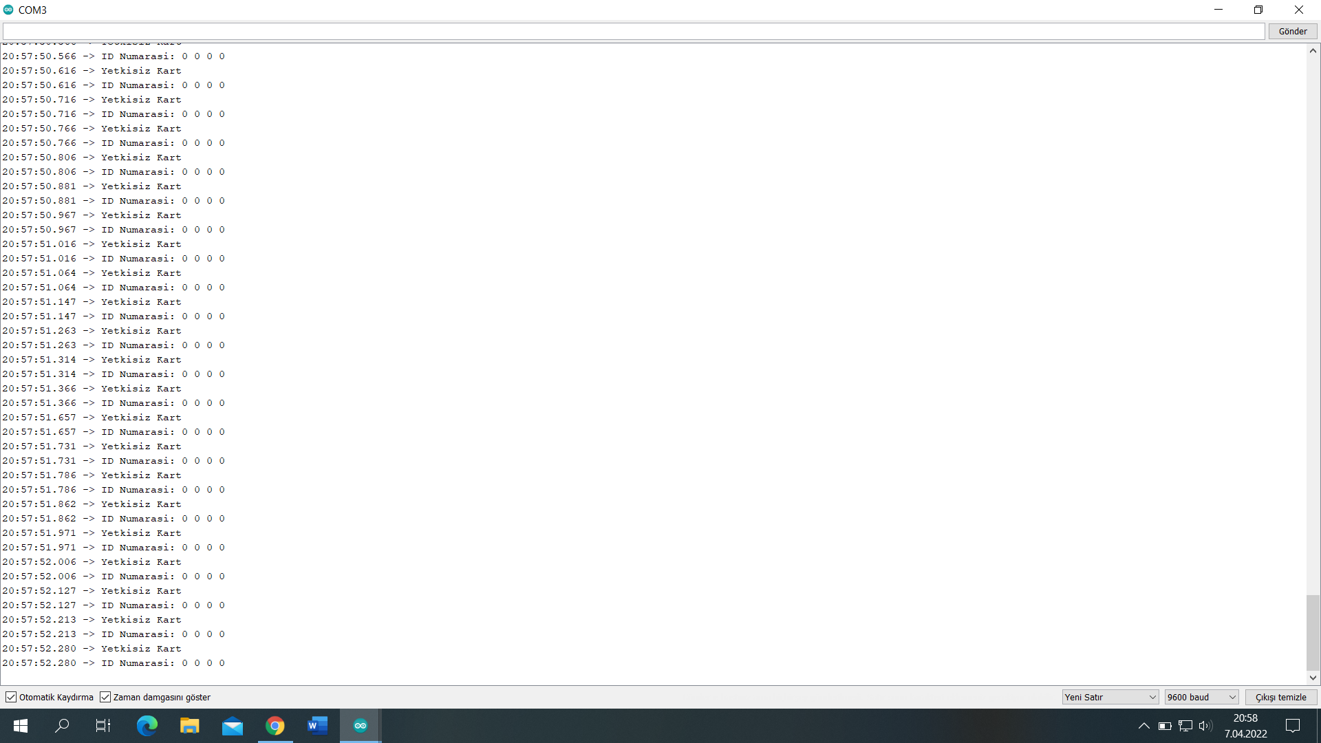

I have a project but I couldn't solve a problem.
I want to control entry and exit using 4 rfids. When the correct card is read, the door will open. After installing the program, the first RFID reads all the cards and the door opens when the right card arrives. But the other 3 RFID is not reading.

This:
 if ( ! rfid.PICC_IsNewCardPresent())    //Yeni kartın okunmasını bekliyoruz.
    return;
Means that if the first RFID reader doesn't see a new card, none of the others will ever be checked.
ı deleted this commend but not solved
Post the new version - don't edit the original.

I edited the code but only the first card reads and this is how it is on the serial port screen.
The problem is all those return statements. I suspect that you took an example for a single RFID reader where they would have made sense and copied and pasted it. You might do better if you put each RFID's code in its own function and call each from loop.
there is an example for Multi RFID readers in the IDE.
Test this example (with two readers)
If you got it working - add more readers.
If all your readers are working - use the principle in your sketch.
