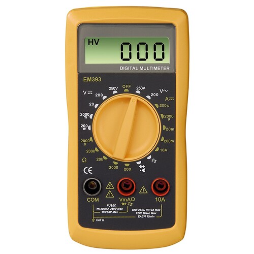

I have a multimeter that has a sign on it, but I don't know what I can measure with it.
It looks like a small square wave:
__
_| |
I have the EM393B multimeter.
I know it's not for: volts (alternating and direct), amps, ohms, diodes and continuity.
See page 14 of the Users Manual - it puts it in the "test signal" output mode.

What will the test signal output do?
Will it send out a signal or measure signals?
If it sends out a signal, why would you want a multimeter to do so
and signal will it send out?
The user manual says:
The output voltage is approx. 5 volts p-p with 50k impedance.
So will it give 5 volts or a signal with max 5 volts?
What does the p-p mean?(Per pin?)

p-p (or pp) means peak-to-peak. So voltage difference between the lowest level and the highest level of the output signal.
An output will never measure (except maybe for the current that is drawn from it). It's an added feature that in principle does not belong in a multimeter; but it can be useful; alternative is to add a far more expensive signal generator to your equipment.
It generates s square wave, like the once popular "signal injector"

That meter is unusual in several ways, not the least of which is that it has the 10A test port on the right hand side - most I've come across locate this feature on the left hand side, away from the normal voltage input.

The meter first cited only claims 250 V. It is not a Fluke.
