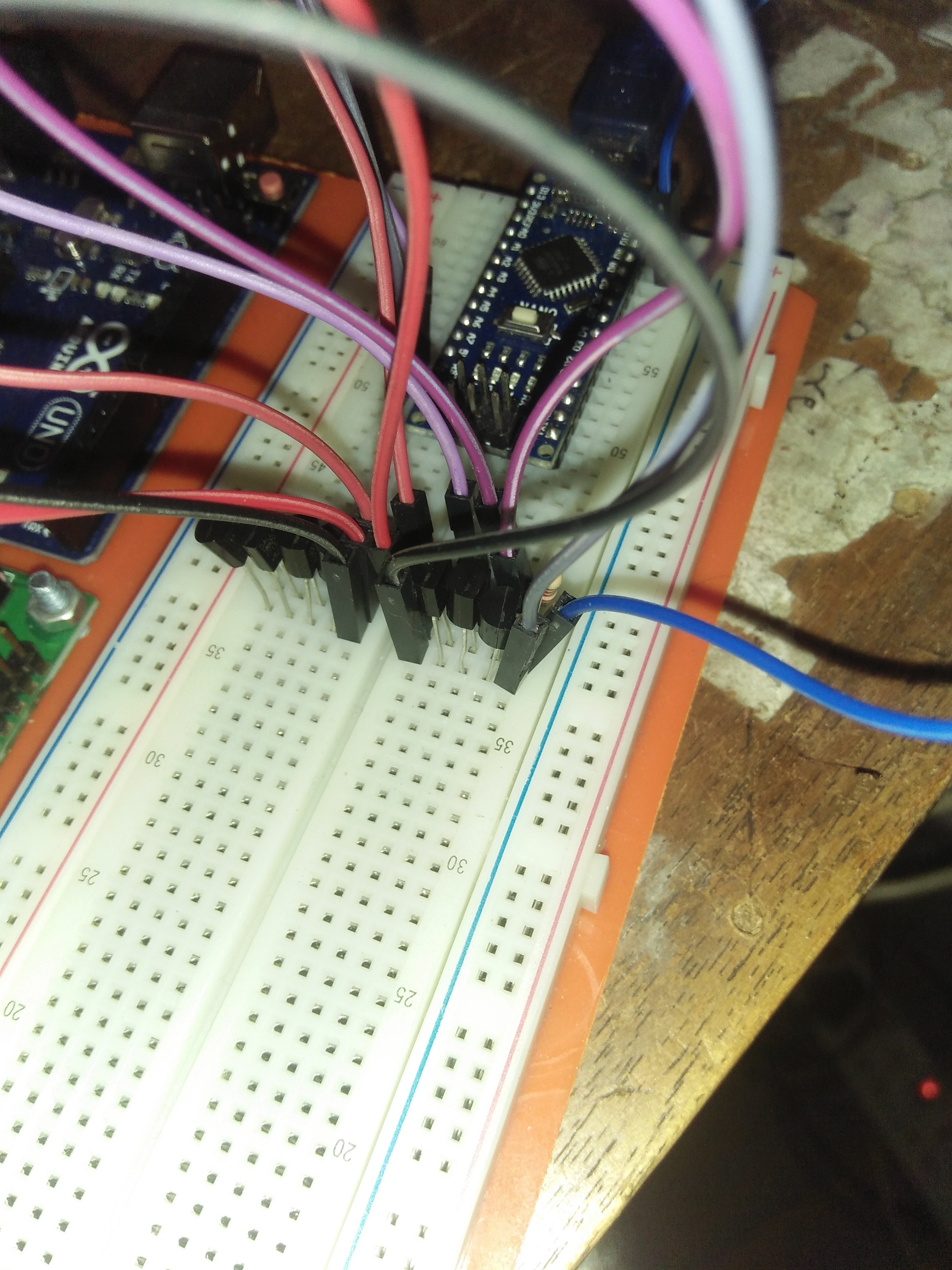

Can you post a picture of your setup? How far are the sensors from each other? I would like to simulate the situation and see what is happening.
All sensors are working, but no more than 4 at a time.
Photo attached. You will see 4 sensors in 2 rows.
They work in any position in either row, or 3+1 or 4+0
Sadly after all this work I am convinced the sensors are faulty

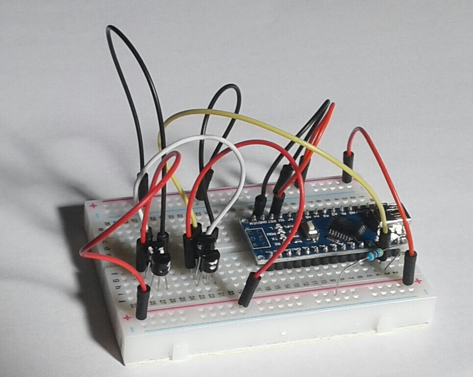

This is my setup for testing 7xDS18B20 sensors simultaneously.
This is your setup:
What are the differences:
1. I have used rectangular-pin jumpers; you have used rounded-pin jumpers which have bad reputation of making either intermittent/high impedance contacts.
2. I have used the pull-up just with the sensor. You have placed it far away from the sensor.
3. I have used minimum jumpers for connection among sensors and NANO; you have used more jumpers. You have made 5V/0V rails, and then you have supplied 5V/0V to the sensors from these rails.
My 7 sensors and @el_supremo 10 sensors are working; your sensors should work?
And if they are still not working, I would solder them together to avoid jumpers and breadboard; they must work at some point?

Can you please, post a picture of the setup of your 10xDS18B20 assembly.
I have 7 sensors - not 10 - but here it is - ARGHHHH. It won't let me attach the photo.
AHA. Got it. I had to strip the EXIF from the file.
Pete

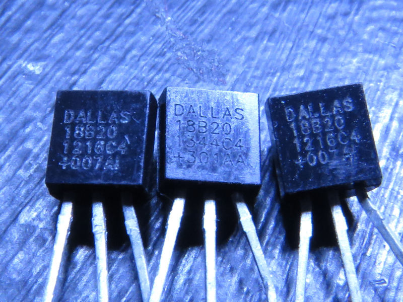

@freddie43: None of my DS18B20 have white paint on the back. Do the front of your sensors look like this:
Pete
Ha ha ha!
The white is Tippex which I used to identify them - a bit like dominos.
Yes they are DALLAS 18B200
But mine have reference 1813C4 +827AH

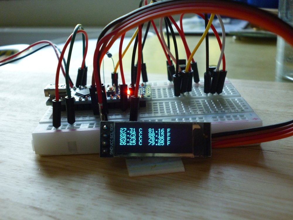

A big THANK YOU to Pete and Golam (from opposite sides of the globe), for their kindness, understanding and being prepared to experiment and go that extra mile and spend their time trying to help me get to the bottom of my problem.
I have enjoyed the last 2.5 years experimenting with a great range of sensors and devices on my Arduinos, and this Forum has been a great place to search for answers. But this is the first time I have actually sought help - and help came in a big way!
I attach a photo of my OLED display of four DS18B20 sensors - which is about as far as I propose to go at the moment. I can see that my original idea of wiring the house up with a load of sensors in parasite mode is fraught with problems like distance and noise. But that can wait.
