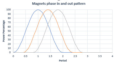

Because this is actually intended to be used with electromagnets and I need them to phase in and out using a sine wave. For demonstration purposes I will be using LED's though.
Rather than compute sin values it may make sense to use a spreadsheet to calculate the values for a look-up-table and store the values in an array. Then the phasing can be managed by choosing the appropriate index into the table.

This is interesting as I already have a spreadsheet with the values I require.
That is the graph I am trying to achieve (minus a smoothing circuit).
So your saying the Arduino would be able to grab the values from this spreadsheet instead of the float function?
No. You need to export the data from the spreadsheet and copy and paste the data into the sketch, as initial values for a const array that you store in PROGMEM.
Your curves all show tangent discontinuities. Is that intentional?

Yes it is intentional as -255 is actually the lowest point (i.e. off) of the LED, not 0. I will have a look into the method you are suggesting.

So my question is, what is the best way to achieve this?
Thanks!
