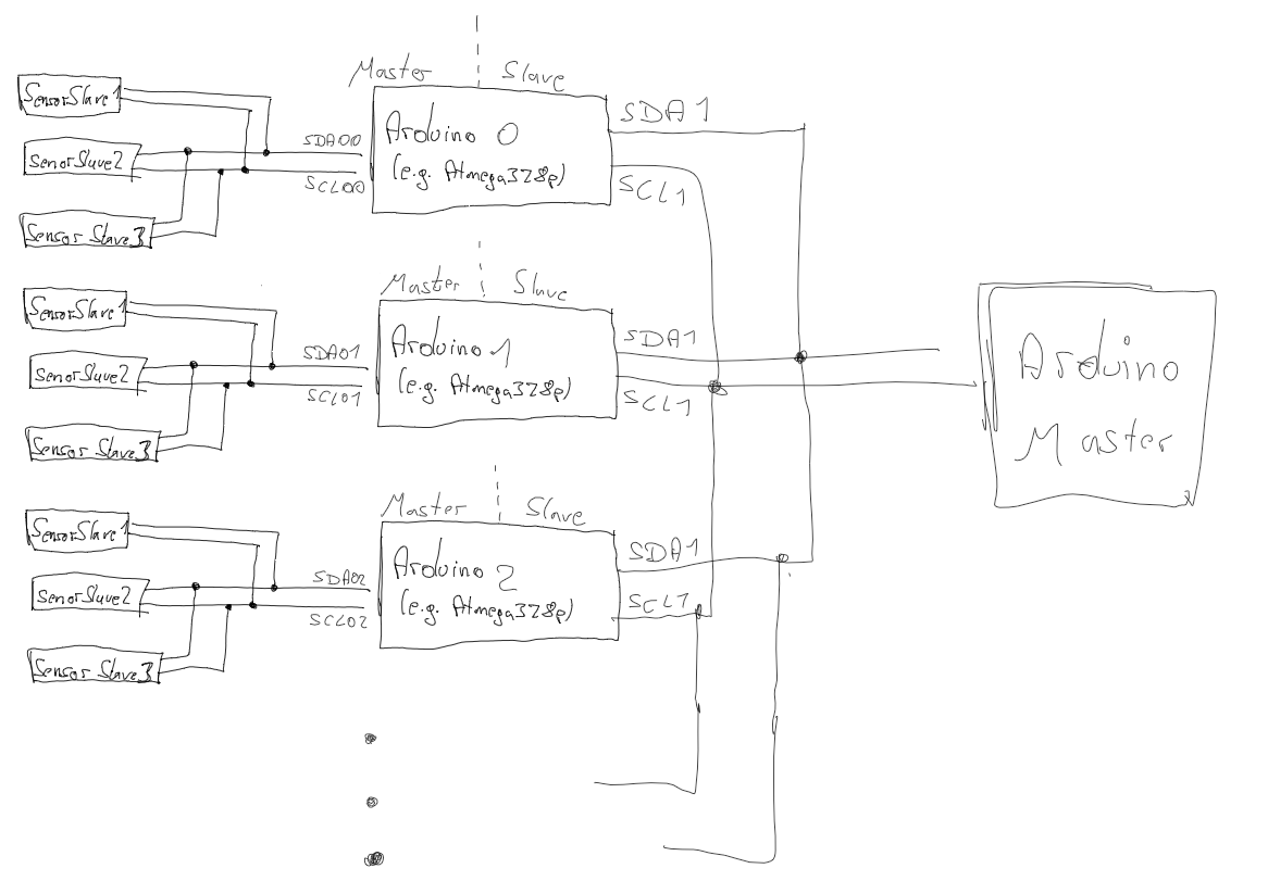

I have an arduino "sensor" board which receives data from 3 sensors over i2c. So for now, my I2C master is the arduino board and the slaves are the 3 sensors. I have many of those sensor boards, lets say 15. So
Now i want to send those information to another ardunio which collects all those informations.
Now the problem:
As i see it, i cannot configure the sensor board as a master for receiving the sensor information and at the same time as a slave for sending them to the "Master" collector board. Am i wrong? Can i do that? If yes how?
Skipping the sensor board arduino and directly sending all information to the "Master" collector board is not an option since the sensors need each ~100ms of read/write time, so 15x3 would be 45 x 100ms. Which is just not applicable.
At the moment my solution is to use SPI which sucks (as you can imagine) because i need 15 select pins...
Any idea or input is welcome.

Are you thinking like this?
Sorry for my bad drawing skills, what i would like to do is the following:
+1k for the nice and readable diagram.
The circuit could be operated using I2C codes.
1. Let the Master of Arduino-0 acquire data freely at regular intervals form its I2C sensors and save them in an array.
2. Arduino Master will ask Arduino-0's Slave to read data from its own Master and then forward the data to Arduino Master.
3. Strategy of Step-2 could be applied for Arduino-1, Arduino-2, ..... on round robin basis.
