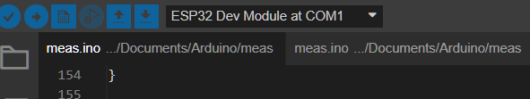

During programming today I noticed that I have 2 instances of the .ino file open. they show also the file location in the tab. I have no idea how it got there or how I can close it.
right-click on tab shows the option (empty)?
Restarting the IDE restores the session with 2 open instances.
Thanks for your report @Xinonix . This is a known bug that is being tracked by the Arduino IDE developers here:

One of the developers did some investigation on it today and found it is a problem with the Eclipse Theia IDE framework the Arduino IDE 2.x is built on:

Those issues were fixed in Arduino IDE 2.0.0-rc7, so at least it should be less likely to occur when using the latest version of the Arduino IDE even if not all the possible causes were fixed. If you are using an older version of the Arduino IDE 2.x, I recommend you to update to either 2.0.0-rc7 or even better to the latest nightly build:
https://github.com/arduino/arduino-ide#nightly-builds
This is unrelated. Since they were not relevant to Arduino's specific use case, the items that would normally appear under that context menu were removed by the developers , but they did not remove the context menu itself at that time. Hopefully the useless empty context menu can eventually be removed, but for now please just ignore it.
I am running the latest version, rc-7, so this might be a new one or an unsolved.
The right-click on tab did show (close-right) in this release, earlier and that resulted in closing the last tab. I could not repeat that action...
Is there a known way to close the second occurance of the .ino file?
Yes. Please follow these instructions:

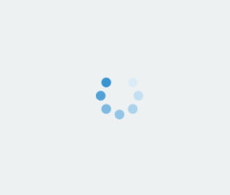

Gives me a
for the last 15 minutes...
Restart solves that one.
Thanks for reporting that. We have been tracking this sort of hang issue here:
