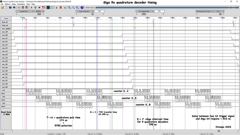

Multiple quadrature decoders on the Giga and Due
The decoders have been tested for the Arduino Giga and Due. The decoders are read and processed via interrupt. Usually edge detection is used for the interrupt routine, but I use a system of fixed sampling time that simultaneously processes all encoders. You can choose the sampling period according to the expected max encoder speed. You can start from the max motor speed and the number of pulses per revolution of the encoder. I use a lot of Fischertechnik motors and they have an unload speed of max 600 tr/min. If you have an encoder of 100 pulses per revolution then you have 600/60*100 = 1000 pulses /sec.
You should also keep in mind that most encoders have a worst-case ratio of 40/60 ratio, so calculate 20% higher speed. I take another 100% safety myself which means I have to make the calculation at 240%, so 2.4Khz instead of 1Khz. It follows that you have to take an interrupt sample at least every 416 us and calculate all encoder positions. I measured the interrupt routine to handle 5 quadrature decoders which is 4691 ns for the Due and 420.5 ns for the Giga. So the Giga is 12x faster. For all tests, I brought the sampling period at 132 us. That's still a lot higher than necessary.

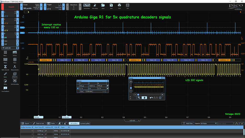

I use an LCD 4x20 char display with I2C. I read that 10x per sec to display position values.
You can see a scope shot here:

The Giga takes about  416 ns to process all 5 decoders in the interrupt routine
The Due  takes about 4691 ns to process all 5 decoders in the interrupt routine
The Giga is about 12x faster than the Due.
Interrupt every 132 us via timer

void Int_Decoder_Handler() {
  // set pin D22 high. Processing time interrupt routine 461 ns
  // Interrupt every 132 us via pin 2, signal given by the Arduino Due.
  GPIOJ -> BSRR = GPIO_BSRR_BS12_Msk;

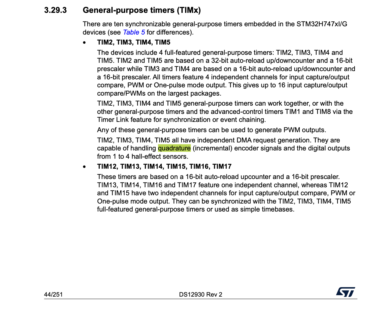

How many encoders can be done with the GIGA's hardware quadrature handling?
https://www.st.com/content/ccc/resource/technical/document/application_note/54/0f/67/eb/47/34/45/40/DM00042534.pdf/files/DM00042534.pdf/jcr:content/translations/en.DM00042534.pdf
From the datasheet at https://www.st.com/en/microcontrollers-microprocessors/stm32h747xi.html looks like 4 at up to 240MHz:
@DaveX
Thanks for the links! That's certainly good info to read.

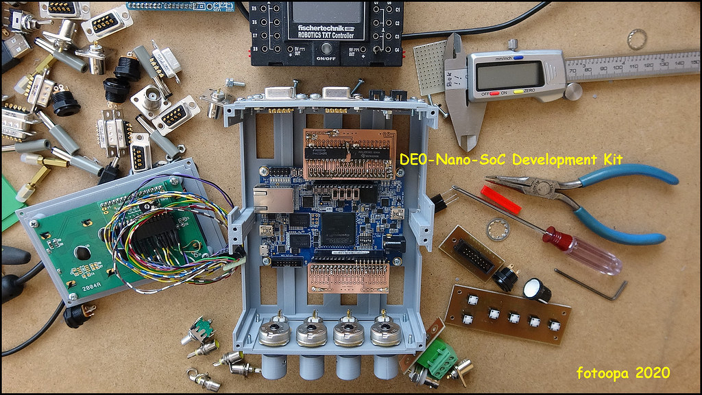

My problem is actually that I am not familiar with C++, I have been working with FPGA boards for years and that is written in verilog. I bought these Arduino boards to get some experience with C++.
My primary concern is to be able to use an simple timer interrupt routine. Those quadrature decoders would be a good example. I don't really need it because on my FPGA boards I have up to 12 motors connected with decoders, min, max and home switch. Inputs and outputs are widely available (120 digital input and output pins via 5 SPI boxes at 2Mhz).
My "DE0-Nano-Soc" board cost only slightly more than a Giga board.
DSC05922 by Frans, on Flickr

Meanwhile, I made a test setup for 9 quadrature decoders. I use an Arduino Due as an encoder generator and the Arduino Giga as quadrature decoder. Since I still cannot write a timer interrupt routine for the Giga, I have to create an external trigger signal for this. This signal also comes from the Due. A photo of the entire setup can be seen here:
Giga-Due_quadrature-20230506 by Frans, on Flickr
As you can see a lot of wires! To make measurements of all signals, I connected a 34 channel logic analyzer. Which operates at 200 Mhz but unfortunately has only a small buffer memory. Given the many wires, I made some adapter connectors where 2 connections can be made for each signal. You can see the capture of the logic analyzer here:
Giga_9x_decoder_0506 by Frans, on Flickr
The photo is a UHD version, click goes to see the original on my Flickr account. An interrupt signal is sent from the Dua to the Giga every 128 us. I extended that pulse slightly so that it is 96 ns wide. But it can also be done with 24 ns if desired. The quadrature signals are created with digitalWrite commands on the Due. Because of this, there is a small shift of 2.11 us per quadrature group. With the Giga, I am also going to pass all the counters serially. I am using TX1, TX2 and TX3 for this purpose. Each TX line sends 3 counters so that all 9 decoder results are visible on the analyzer. I do this at 2Mbd speed. You can go up to 4Mbd which makes counter transfer even faster. There is plenty of time between each quadrature change. So you can see any change in the counter, even at this high speed. Every 174 us, the quadrature signals are changed. This corresponds to 5750 pulses per sec. If you have an encoder of 100 pulses per revolution then it may run (5750/100)*60 = 3450 tr/min. I also created a measurement signal in the Giga that records the time to fully process all 9 quadrature signals including calculating the new position. That time is 795 ns. You can also see on the timing that I need very few interrupts for all 9 quadrature decoding. If you used edge detection that would be 4x9= 36 interrupts per full quadrature. I have a maximum of 6. You can see that this system consumes less interrupts! I can also measure the time between receiving the interrupt signal from the Due and starting processing from the Giga. This time is 510 ns.

GPIOJ 12  D22         D22         trigger ouput 9 decoders
Due D2 -> Giga int    D2
serial2   TXT1        D18   serial counter 0..2 outputs
serial3   TXT2        D16   serial counter 3..5 outputs
serial4   TXT3        D14   serial counter 6..9 outputs
#define PIN_int_decoder 2    //interrupt request pin 2
  Serial2.begin(4000000);  // TX1 pin 18
  Serial3.begin(4000000);  // TX2 pin 16
  Serial4.begin(4000000);  // TX3 pin 14
  pinMode(D22, OUTPUT);    // scope trigger signal
  digitalWrite(D22, 0);    // trigger scope low
  // Interrupt every 128 us via pin 2, signal given by the Arduino Due.
  GPIOJ -> BSRR = GPIO_BSRR_BS12_Msk;     // set pin D22 high for scope

  GPIOJ -> BSRR = GPIO_BSRR_BR12_Msk;     // set pin D22 low for scope
I am still looking for a solution to write a timer interrupt routine so that I no longer need the external trigger signal on the Giga.
Frans
I am still trying to write a timer interrupt routine for the Giga. I have searched a lot for solutions, including the Portenta H7.
But still without success. The data sheet of the STM32H747 is almost continuously open here. It is still searching through the many pages (the manual has more than 3500 pages!). I tried to initialize Timer2. That should call an interrupt routine every 128 us. The task is pretty simple but it still doesn't work. I use the logic analyzer to see the results.
Here I have the init routine and the interrupt handler routine I'm trying to get going. I seem to be doing things wrong, too little or not in the right order. I have been trying to change some things for days without success. Can anyone help me with this?
type or paste void timer2_setup() {
  TIM2->CR1 = TIM_CR1_URS                // Only counter overflow/underflow generates an update interrupt if enabled.
            | TIM_CR1_CKD_1              // 01: tDTS = 2 × tCK_INT
            | TIM_CR1_CEN;               // Counter enabled.
  TIM2->CR2 = TIM_CR2_TI1S;              // TI1 Selection
  TIM2->CR2 = TIM_CR2_MMS_0;             // MMS[2:0] bits (Master Mode Selection)
  TIM2->DIER =TIM_DIER_UIE               // Update interrupt enable
            | TIM_DIER_CC1IE             // Capture/Compare 1 interrupt enable
            | TIM_DIER_CC2IE             // Capture/Compare 2 interrupt enable
            | TIM_DIER_CC3IE             // Capture/Compare 3 interrupt enable
            | TIM_DIER_CC4IE             // Capture/Compare 4 interrupt enable
            | TIM_DIER_TIE;               // Trigger interrupt enable
  TIM2->CNT = 100;                        // TIM counter register
  TIM2->ARR = Auto_reload;                // Auto-reload timer2 value
  // TIM2->EGR = TIM_EGR_UG;              // sofware Trigger Generation
  TIM2->SR = TIM_SR_UIF                   // Update interrupt Flag
            |TIM_SR_TIF;                  // Trigger interrupt Flag// Update interrupt Flag
  attachInterrupt(TIM2_IRQn, Int_Decoder_Handler, RISING);
  //NVIC_ClearPendingIRQ(TIM2_IRQn);
  NVIC_EnableIRQ(TIM2_IRQn);
  GPIOJ -> BSRR = GPIO_BSRR_BS12;     // set pin D22 high for scope
  GPIOJ -> BSRR = GPIO_BSRR_BR12;     // set pin D22 low for scope
  TIM2->SR = TIM_SR_UIF;              // Update interrupt Flag
code here
Placing the interrupt handler code in the mainloop does work, this proves that my logic analyzer does connect to the correct output pin.
How interrupts work I do understand, I worked with them for 30 years with the Motorola CPUs.
Frans.
I can not say for certain, but I believe timer 2 may be used by system, try using another timet.
Yes I have already tried several other timers. It is clearly the setup code that is not written correctly. I see that there are 26 x 32bit registers per timer that you can set; that remains a puzzle.
update:
@bexin
I suspect that timer2 would indeed have been used, I am now testing with others but unfortunately still without results.
@fotoopa did you ever come up with a solution for the Giga?
