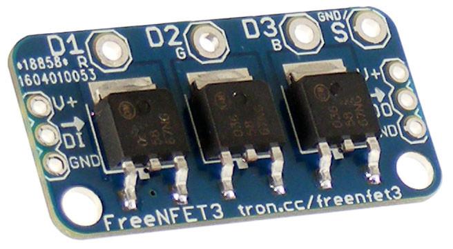

I'm working on a large art installation, and I need to control 54 LED strips, 2m each, so 6480 LEDs.
BUT! I only need to display one color for each strip, so 54 colors at a time.
(we don't really care for now about the number of power supplies I need...)
I need each strip to be considered as a unique long pixel.
So, instead of running a massive chained strip of 6480 adressable pixels like neopixels
(much more that an arduino could handle),
I'm trying to find a way to consider each strip as a single long pixel,
and to control it like I usually control one strip of neopixel.
For now my plan is to use SMD5050 LED strips,
and adding a driver at the beginning of each strip.
But I have no idea if such a driver exists...
I'm looking for something that could act like the WS2811 driver in the neopixel,
to be capable of setting the color of a whole strip.
The best would also be to be able to use the fastLED or neopixel libraries for these 54 "long pixels"
Is something like that is actually possible?
I can guess that the WS2811 is not powerful enough for a whole strip, or is it?
The other option I'm looking at is to use 11 TLC5940 multiplexers.
This will allow me to have enough pwm channels to drive the 54 x 3 (rgb) required pwm.
Again, does that sound possible? Is chaining 11 TLC5940 multiplexers feasible?

Adafruit 16-Channel 12-bit PWM/Servo Shield - I2C interface : ID 1411 : $17.50 : Adafruit Industries, Unique & fun DIY electronics and kits with a suitable mosfets might suite your needs.
Maybe something or this? It's a small board containing a ws2801 chip, plus 3 MOSFETs for driving up to 5A per channel. It even has a regulator so the whole board can be powered from 12V.
Or this one based on ws2811:

PaulRB:
Nice! This is exactly what I had in mind but I didn't found these ones. Seems perfect. If it works a intended, it will let me drive each analog strip as a single pixel in FastLed! I have to try these as this might be the easiest way to do it.
Again, thanks you all three for these ideas, I was really curious to find a way to build huge setups. I'm still making my homeworks to learns the limits and possibilities, but your solutuions are clever :slight_smile:
that why I wanted to find a way to drive 1 strip with only one ws2801 to get the best of both world.
Sadly that is not going to work as the ws2801 has a constant current output so is only suitable for driving LEDs in series. And that with a maximum voltage requirement of 7V.
