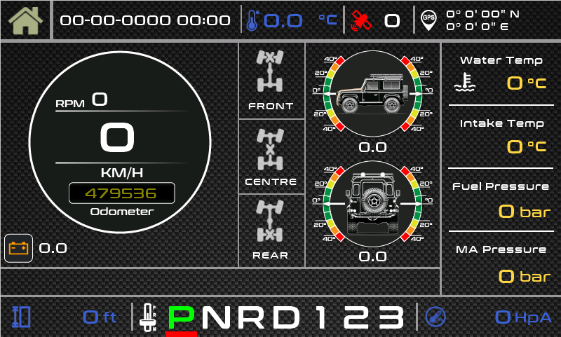

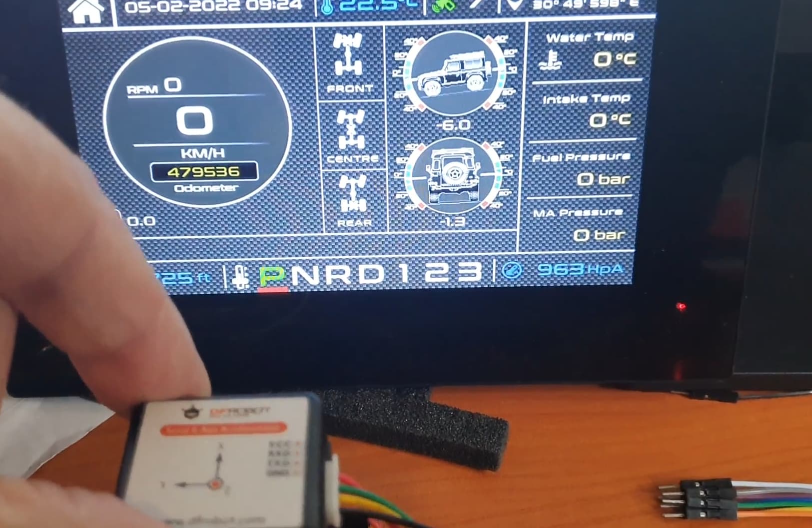

Yes I agree with your sentiments regarding the speed at what humans are able to read. This project is for a new DIY engine management system which I installed into my vehicle. The main reason for "as fast as possible" is so that I do not see jerky readings, there is nothing critical about the application. The two readings in particular are the RPM and the inclinometer graphics. I have attached one screen which may give a better idea.
With data.
