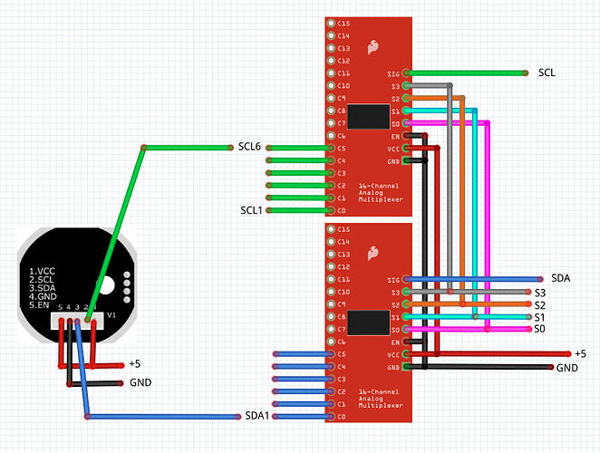

As you already know from the DFRobot wiki page:
This sensor is sealed by software IIC, and can not be used with other equipment or sensors using hardware IIC.
So you can forget about the I2C MUX.
However, you can use two 74HC4051 analog multiplexers, one for SCL and one for SDA.
So besides pins for SCL and SDA, you will need 3 more pins to control the 4051.
Do you have 3 pins avaliable?
If you need a wiring diagram just let me know.

Hi Jim-p
I have two 74HC4051 and waiting on delivery.
Do I just use the same pins for switch both multiplexers?

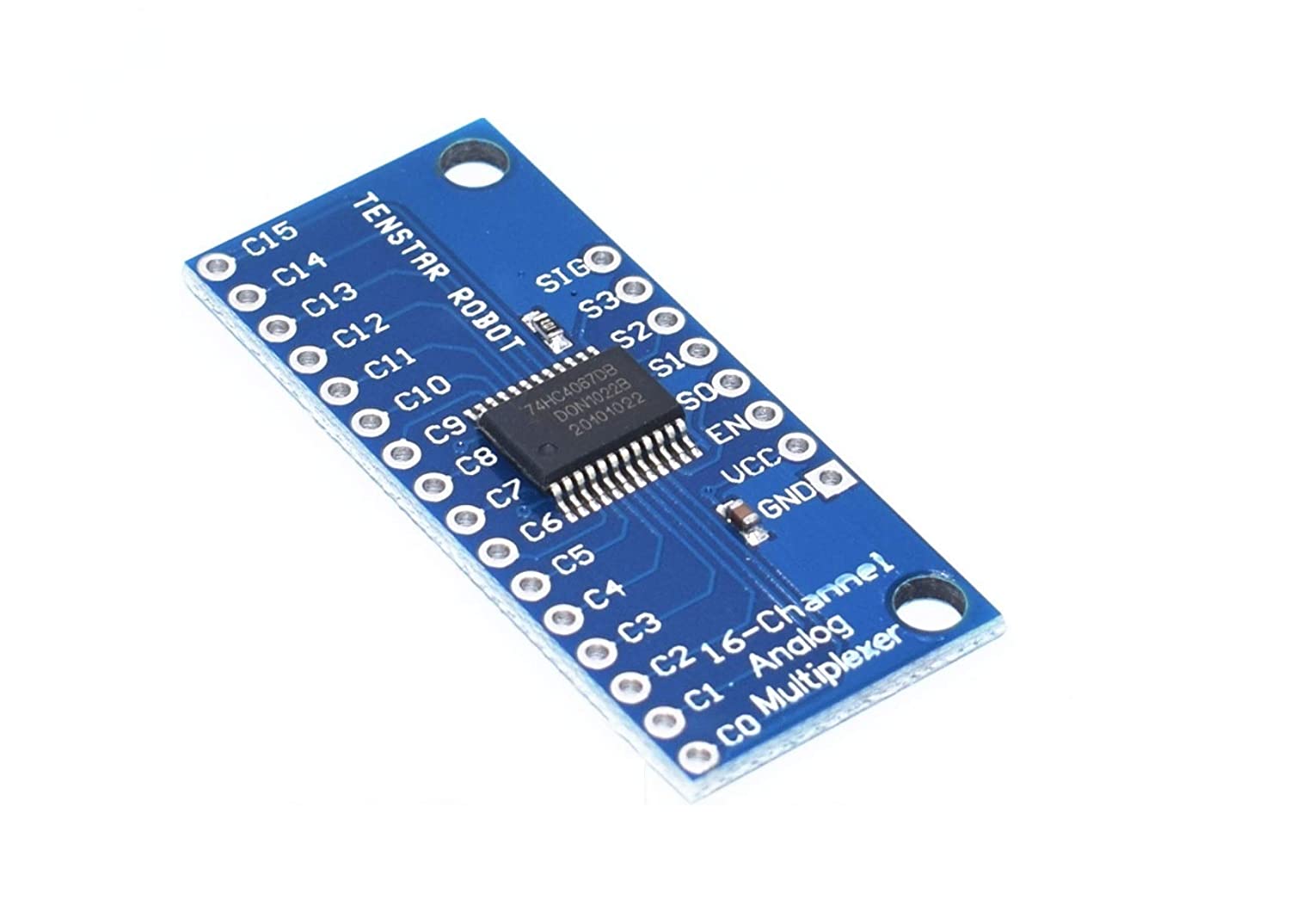

Did you buy the ICs or the little boards?
If you have the IC:
Why it needs be analog to switch a digital pins?

It's not the analog part. It's the bidirectional part that matters.

Hi Jim-p.
These are the boards a bought.
Are you suggesting ther is a way to do it with a digital MUX?
I don't know how.

I got it to work :slight_smile:

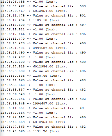

HI jim-p,
Now i have run in to another issue.
I get incorrect data, when I connect the sensors to a long wire.
Could this because I switch to fast bestween them. I have put in a delay between readings, but i dont know if i need a dealy somewhere else?

Skærmbillede 2024-06-24 120702
they sometimes read the correct data, just not everytime
