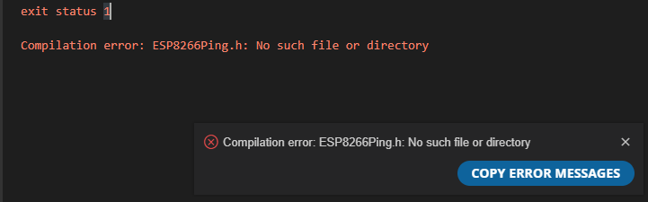

I tried that but somehow I can't get libraries installed that need to be installed with a zip file. Just installing libraries via the library manager is possible, but I don't think ESP8266Ping is listed there.
You could try one of these
Many thank Z80,
ESPping did the trick!!!!
