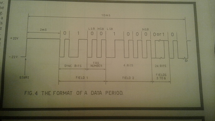

Need to import into Arduino a existing datastream from a vintage TMS1000, I have the format etc.
Then on a new datastream built on Arduino add a new very small addition to the original datastream. This datastream sends data to up to 16 receivers
This new datastream is to add new addresses (say up to 17-64 addresses) on the bus (over and above 16 addresses from the vintage TMS1000, Say to add #21 . New receivers will be built to receive the new addresses.
Datastream #2 to be inserted into #1, and then returned from Arduino to original data bus.

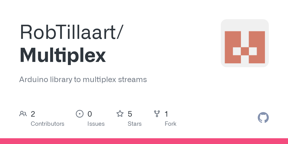

Please always post a link to the library you are referring to.
Is it this one?
Why do you believe this library will help you?
From figure 4 the format of the data period I see that the MultiPlex library is not suitable.
The MultiPlex lib is used to multiplex serial streams which have a HIGH(1) and LOW(0) value
with a fixed duration per bit.
Your stream has a pulse per bit and the encoding is in the duration of the pulse. SHORT = 0 and LONG = 1. The library does not handle this type of data.
I assume that the 10 milliseconds in FIG4 is an estimate as you do not know how many 1's and 0's there are.
That said, I think it is possible to create a multiplex for this kind of data stream if I understand the requirements correctly.
I would use a MCP23S17 (the SPI based) that could send out 16 bits in parallel, put 4 of them side by side and you have 64 channels. If the MCP23S17 meets the timing requirements is to be tested.
