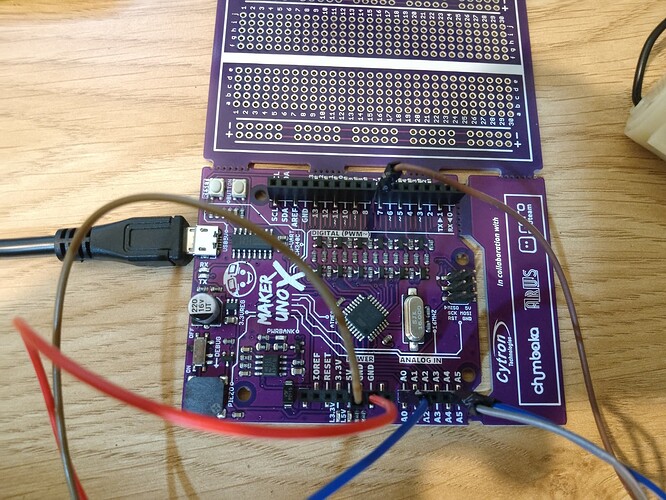

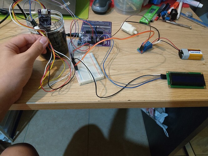

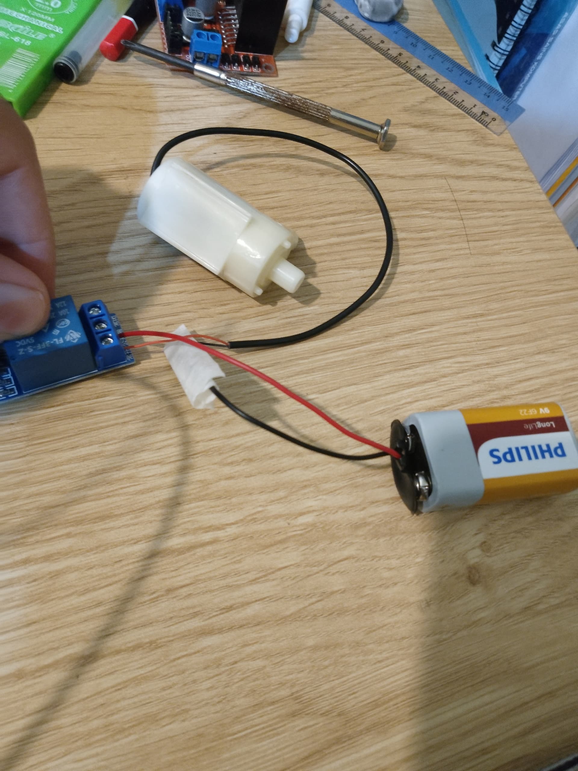

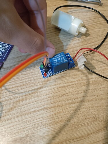

sorry to ask one more question :sweat_smile:. May I know why the led sreen is not showing anything? and also the water pump is still running while the soil in moist condition? Is it my material problem or coding problem? Tq!!!
I assume that the relay turn the water pump on and off. Does the pump run when you write LOW to the relay pin or when you write HIGH to the relay pin ?
Do you see anything printed in the Serial monitor and, if so, do the messages match the actual soil condition ?
yes the pump is still running while the relay pin is LOW
Do you mean your lcd display?
Show us how everything is connected... AND
the links to the tech info of the sensor, the board you are using and relay.
the message is match with the actual soil condition but the pump is not running as I expect....
Relay modules used with Arduino boards are usually configured to be active LOW, ie the relay turns on when its input pin is LOW
If that is the cause of your problem then you can fix it in one of two ways
Method 1 : Change the program to output LOW when you want the relay to turn on and HIGH when you want it to turn off
Method 2 : change how the pump is wired to the relay so that power is supplied to the pump when required. The relay will almost certainly have a Normally Open (NO) and normally Closed (NC) contact and a Common contact to allow you to do this
