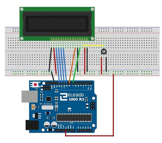

Hey, I'm actually following a tutorial from a YouTuber (not any random one, he's a really good youtuber) and I'm doing just as he is and he is the one who designed the circuit he got it right. I didn't see any comments complaining about this issue so it's definitely an issue on my side. I don't have an I2c daughter board, and I don't even want to buy one just yet, I want to learn how stuff goes like this ('the old way' as you mention).
And by adjusting the backlight are you implying that the brightness of the LCD changes when the potentiometer is turned?
Coz that's NOT happening with me. The brightness of the screen is constant throughout the potentiometer's range. Also, I forgot to mention that I also tried putting a resistor on the 15th(BLA) pin in series to the 5V, (as shown in the circuit diagram of the LCD Hello World sample program on Arduino's official website) and doing that reduced the brightness of the 'backlight' meaning that my LCD is capable of doing that too, but isn't doing it for some reason.

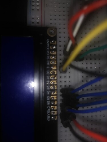

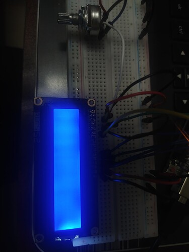

I hope these are sufficient. (Please check the soldering too, I'm a beginner at soldering)
The wiring follows tge same colour scheme as in the circuit diagram, except the orange in diagram is replaced with a yellow wore and the yellow in diagram is replaced with a white wire.
I can snap more pictures if you want me to.
The circuit diagram on that website is exactly the same as mine.

That soldering will not do at all.
Fix that, add the #include <LiquidCrystal.h> line to the top of your sketch as shown below, and it'll work.

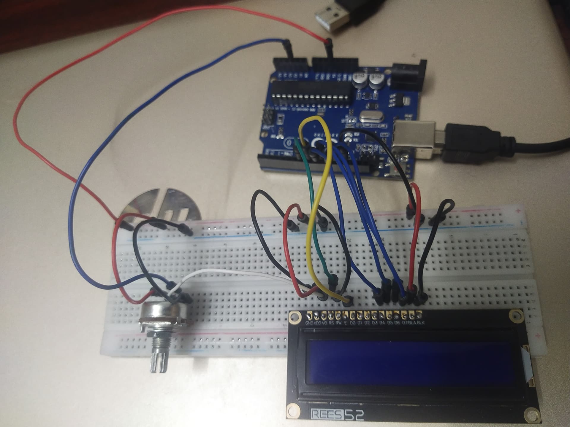

The backlight pot seems to have an extra wire. The blue wire on the left. The pot should ony have G 5V on the outside pins, and the wiper connects to the BRIGHT pin, 3rd from the left I think.
I do have #include <LiquidCrystal.h> in my code, it didn't get selected when I was copying the code ig, sorry for that :sweat:
Then once you fix that soldering you should be fine, if you've wired it up as that Fritzing diagram and my photo show.
The blue wire on the potentiometer is not extra. It is coming from an Analog pin which I've used to perform analogRead to check if the potentiometer is working correctly or not.
My wires are following this circuit diagram. I will try to re-solder it tomorrow

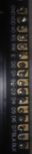

This isn't good:

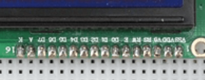

Compare the solder joints with @van_der_decken 's image:
That's what you should aim for.
Soldering_Results
Once you confirm the POT is working, remove the bluw wire in case it is having some side effect.
NOTE: Unless you just happen to have one of the two good brands of bread board, they are famous for bad connections. wiggle all the wires to check. The pictures are not good enough to truly tell, but the wiring seems to be right.

You will need to fix your soldering first.
It looks like not enough heat and not long enough application of the soldering iron to let the solder flow.
