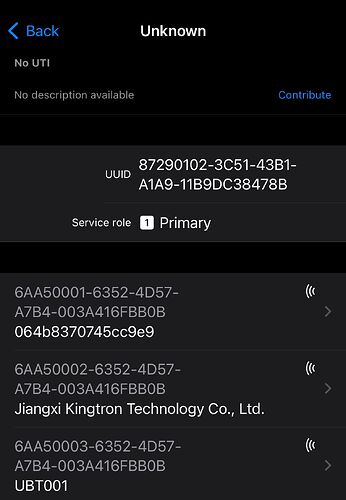

I'm trying to use my Nano 33 BLE Rev2 to connect to a BLE tag i have.
I used the example from the ArduinoBLE repository: ArduinoBLE/examples/Central/PeripheralExplorer/PeripheralExplorer.ino at master · arduino-libraries/ArduinoBLE · GitHub
I'm able to scan and display available BLE Devices but i can never connect to them, it always fail.
The tag is an "Ultrbeka" one I ordered on Amazon and i can easily see it on my phone using LightBlue or BT Inspector on iPhone and also list its characteristics.
Hereunder a screenshot of one of the service:
The board seems to work as i was able to create a fake device "Blank" on LightBlue and make it discovered by my board:

I'm really wondering why i cannot connect to anything else than this fake service with my board ?

Hello,
Can you please :
  • Verify BLE Tag Compatibility: Ensure that the BLE tag operates on standard BLE protocols and doesn't require poprietary methods fo connection.
  • Review Security and Pairing Requirements: Some BLE devices necessitate pairing or bonding before establishing a connection. The ArduinoBLE library currently doesn't support pairing. If the BLE tag requires pairing, this could be the root of the connection issue.
  • Update Firmware and Libraries: Ensure that your Arduino board's firmware and the ArduinoBLE library are up to date, as updates may resolve compatibility issues.
