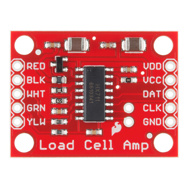

Connect Vcc to 5V (VBUS) and Vdd to 3.3V
what is Vdd? I used the HX711 from M5 stack. it has only 4 channels: DAT, CLK, 5V, and GND
OK the M5 does not have Vdd.

Then the only difference is that the Uno is 5V and the ESP is 3.3V and there is nothing in the M5 stack documentation that says it will work at 3.3V
they are.... they are compatible with 2.6-5.5V
This one will work with 3.3V DAT and CLK signals
You connect Vcc to 5V and Vdd to 3.3V
I wonder which choice you made here --
That's the data sheet for the HX711 part. The M5 stack module makes no claims about 3.3V.
The exitation voltage for the loadcell may not be high enough when that module is used with 3.3V
