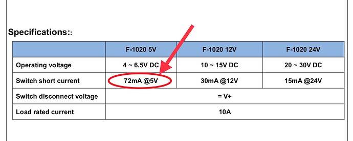

Give us a link to the relay module’s data sheet.
I was measuring pos 5v to the pin to get those readings, when I measure the pins to ground as you suggest I'm only getting 4.9v. Maybe a pullup resistor on the output pins?
I can't find the datasheet, but it's this module- 12V 10Amp Forward and Reverse Relay Module for Motor / Linear Actuator, Reversing Relay Module
  • Data sheet:
https://www.czh-labs.com/tmp/madeimg/datasheet/f-1020.pdf?_gl=1*1yvuq1t*_up*MQ.._gaODk5NDI1MTI4LjE3MTA1Mzc0MTk._ga_SWTWKN09K5MTcxMDUzNzQxOC4xLjAuMTcxMDUzNzQxOC4wLjAuMA..
  • This is troubling:
  • Think you had better use an interposing relay (or MOSFET) and control it with the Arduino.
"in your case, the demands of your project, the 5V 40mA output is inadequate."
