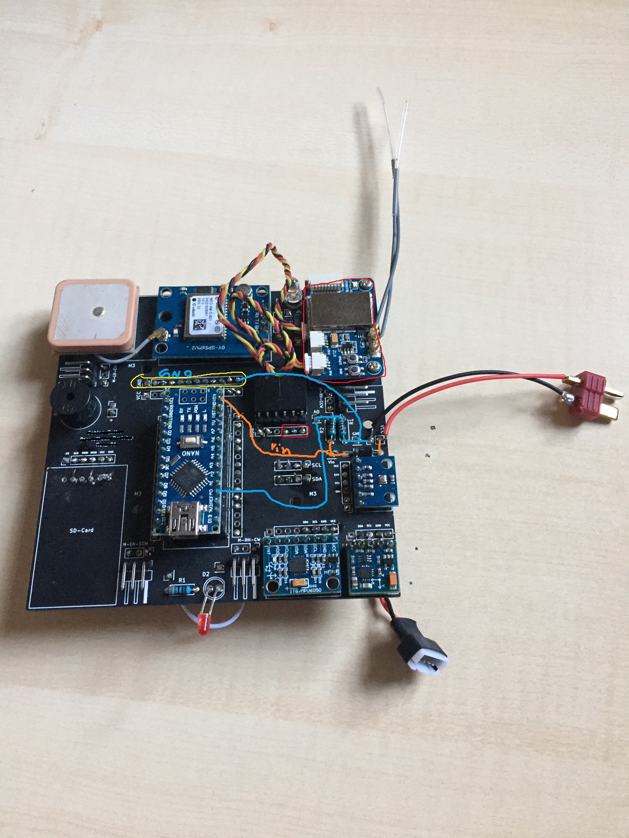

One problem you have, there are NO BYPASS CAPACITORS on the power wires.
Also your gnds are all over the place , you should be grounding ALL your peripheral devices to ONE place and this place should be where the gnd from your LiPo connects to the board.
Can you please post a picture of your project so we can see your component layout.
Not a fritzty picture.

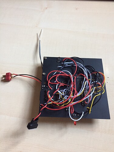

I attached two pics of my Prototyp-PCB. The cabeling is awful... sry...
In the Top Picture, the yellor lines are the GND-pads, where a connected als GNDs togehter (5V-pads are beside). The red lines shows the Receiver and its 5V, GND and Signal pads. Blue line go first to GND, and after the resistors-volt-divider to A0. The Orange lines go to Vin (like in my schematic).
I will rewrite my schematic with kiCAD on the weekend :slight_smile:
