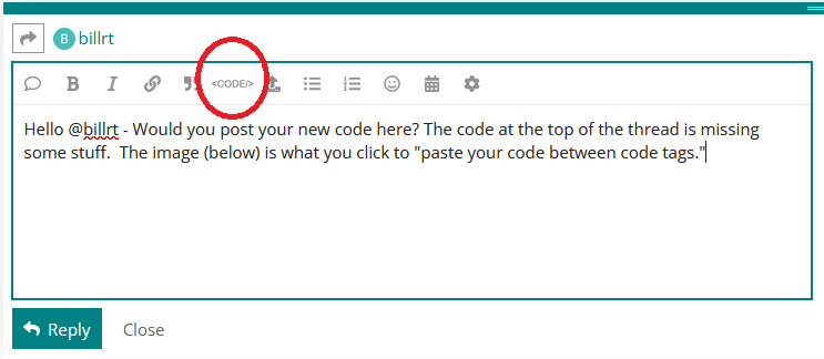

Edit your post, select the code and click on </co de> (maybe </>) in the editor's toolbar.

Hello @billrt - Would you paste your new code here? The code at the top of the thread is missing some stuff and I think I did not get all the changes. The image (below) is what you click to "paste your code between code tags."

The "tags" are actually "THREE Back-ticks"... which once were literally < code > and < /code >
My "back-tick" is on the "tilde" key, next to the "1" - and the edit box has a < code > button for making those "code tags."
This is WITHOUT code tags.
This is WITH code tags.
