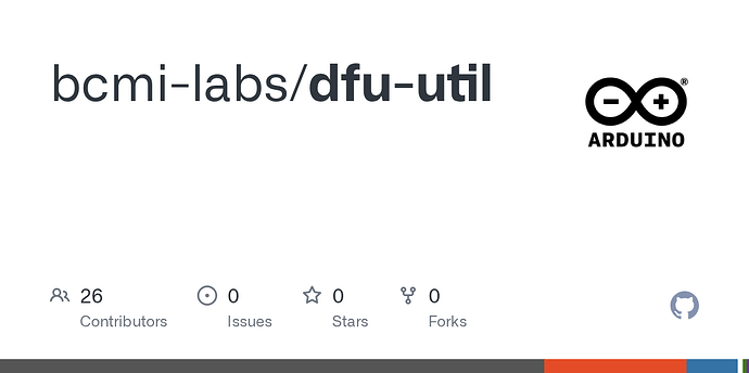

Yeah, this is something the Arduino developers added to the variant of dfu-util that Arduino distributes.
So it would be necessary to build Arduino's variant of dfu-util from the source code in order to have a native Apple Silicon of that tool with the -Q flag support. Unfortunately I am having trouble tracking down that source code right now. I have asked the developers about it. I'll make an update here if I am able to find it.
If you provide the full text of the error you are experiencing we might be able to help you with that.
I tracked it down. The source code for Arduino's variant of dfu-util is here:
So if you build it from source on an Apple Silicon machine the generated binary can be used as a replacement for the tool installed by Arduino Boards Manager without requiring Rosetta 2.

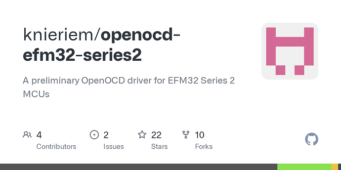

I see. It looks like the arduino:openocd@0.12.0-arduino1-static variant of OpenOCD that is used by the "Silicon Labs" Arduino boards platform has been modified to include this driver:
That "efm32s2 driver" is used by the command defined in the "Silicon Labs" platform for uploading to the Nano Matter board, but the "driver" is not present in the official OpenOCD build, so that is why you get this error when you try to use the official OpenOCD binary in place of the one from arduino:openocd@0.12.0-arduino1-static.
It looks like the developer of the efm32s2 driver was kind enough to provide high quality instructions for building OpenOCD from source with that driver, so I think it should be possible for you to create a native Apple Silicon build of OpenOCD with that driver.
Thank you so much ptillish. I will be very grateful if I could have more detailed instructions on how to rebuild on my Mac M4 the efm32s2 driver.
To be honest I landed to same link a few days ago and gave some try to rebuild openOCD driver but so far I have not been successful :pensive_face:
So any help is appreciated!
Unfortunately I am not knowledgeable in this subject matter. I only know what I read in the documentation of that GitHub repository I linked.
Hopefully one of the other forum helpers will be able to provide assistance.
I think it will be productive for you to provide a detailed description of exactly what you did and exactly what happened that did not match your expectations. Make sure to provide the full and exact text of any relevant warnings or error messages you encountered.
New update (no success so far!)
Installed prereqs:
  • brew install autoconf
  • brew install libtool
  • brew install automake
  • brew install pkg-config
  1. mkdir openOCD_ARM64 (name of my choice)
  2. gh repo clone knieriem/openocd-efm32-series2
  3. cd openocd-efm32-series2
  4. ./setup-openocd-src.sh
Setup complains that libjaylink-0.2 is required
checking for libgpiod... no
checking for libjaylink >= 0.2... no
configure: error: libjaylink-0.2 is required for the SEGGER J-Link Programmer
So….
4B.
gh repo clone https://github.com/syntacore/libjaylink.git`
cd libjaylink
$ ./autogen.sh
$ ./configure
$ make
$ make install
4C. Run again ./setup-openocd-src.sh
5. ./build.sh
It seems that everything is OK BUT cannot flash the board !
