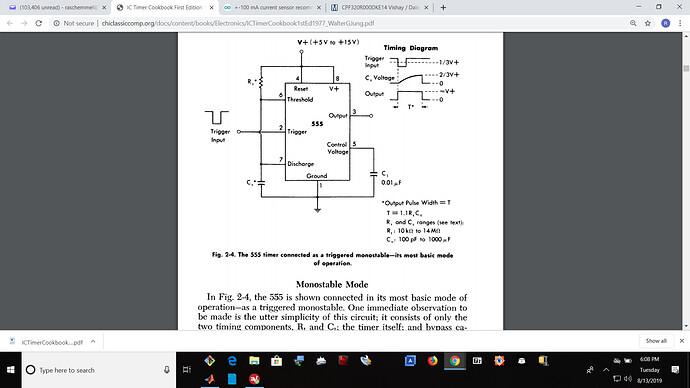

Just imagine getting a book on Timer ICs and
spending 3-months building circuits and wiring them to the leds , pots and switches. In the end, it all comes down to wiring 10,000 points, one point at a time.
This is the book. (William Shatner autographed it at the event)
FYI- The link above is to the 13 Mb PDF free download of this book. (take it !)
Ive never really met anyone all that famous.
Thanks on the pdf link, I downloaded it...it might interest me since I like to tinker with all sorts of things.
Look up Monostable Vibrator (that's your LM555 TIMER delay circuit.
