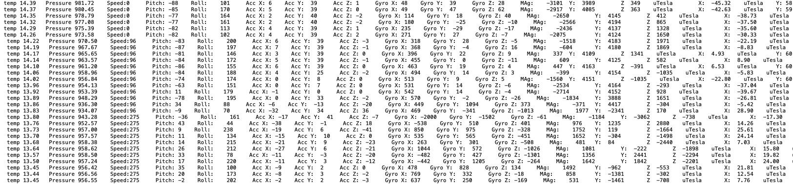

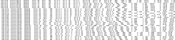

Im working on a model rocket flight computer and my data logging is a little messy. During a flight the data values can go from 0 to 200 to -300 and it makes the data log messy and hard to read, how could i go about fixing this? Here are 2 pictures of the data log file during flight, and the part of my code data logging.

Put a comma between each data item instead of spaces and BINGO ! you have data that can be imported into a spreadsheet
Wow.... didn't realize it was that simple, thanks!
Also print out your parameter names separated by commas once to the CSV file before logging any data and you will then have column headings in your spreadsheet too.
