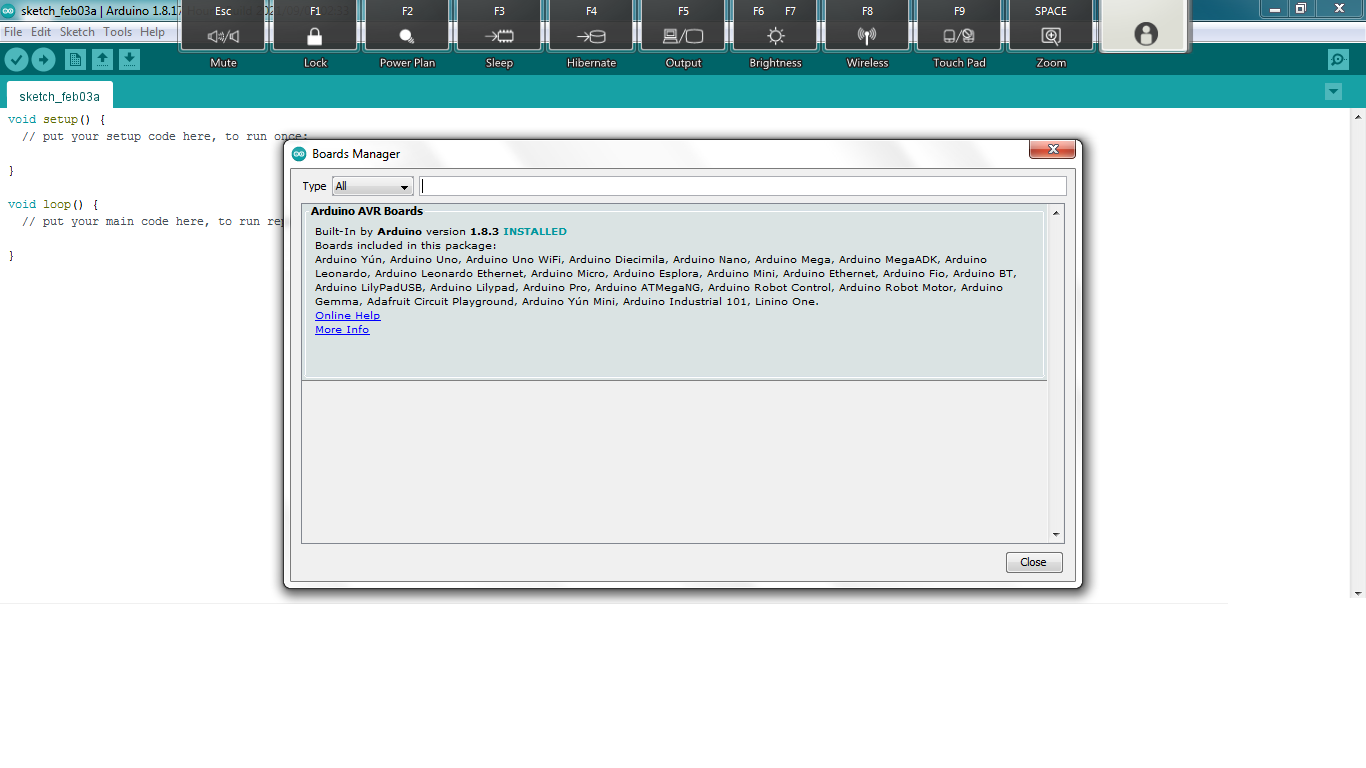

My development computer is not attached to the internet. I am trying to use the board manager to bring "Mbed" in so this board (RP2040) can be used but having difficulty. Is there a way to down load what ever drivers are needed and install them manually?
