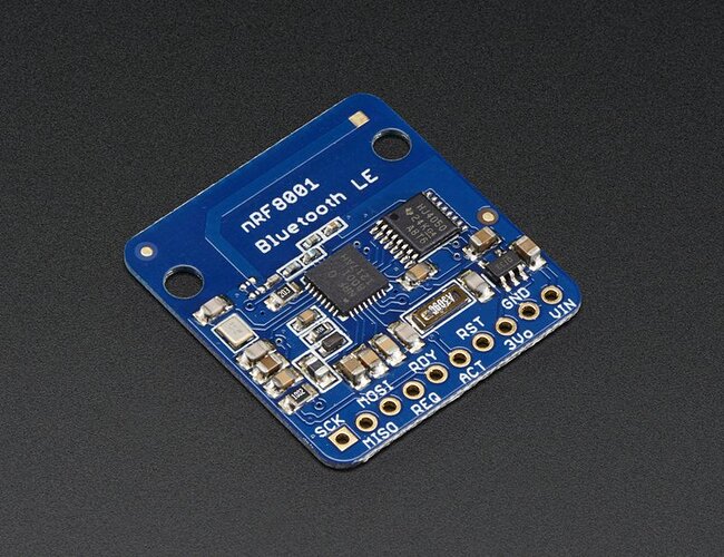

Do you think this ( Introduction | Getting Started with the nRF8001 Bluefruit LE Breakout | Adafruit Learning System ) is better than Tinysine ( http://www.tinyosshop.com/index.php?route=product/product&path=65_110&product_id=705 ) ?
I have funds to invest on either one of those. Since I need to invest a few more on other stuff as well. So, Im in a tight position to choose any one from those 2.
And BTW, I will try to code my own APP for iPhone since I have a developer license sticking around.
rshnk90:
Do you think this ( Introduction | Getting Started with the nRF8001 Bluefruit LE Breakout | Adafruit Learning System ) is better than Tinysine ( Serial Bluetooth 4.0 BLE Module - iBeacon ) ?
No. See my previous. The adafruit is an SPI device. I have no idea how that would work, or why anybody would want such a thing, and I certainly wouldn't pay $19.95 to find out. I also note with faint interest that it apparently won't work with Android, which seems an exceptionally stupid restriction.
The Tinysine is a serial device, exactly as one would expect. Indeed it looks, walks, and quacks like the familiar HC-05, so I see no reason to get anything else.
The BLE<>Arduino waters are rather muddy and I suspect this is down to manufacturers, but the Tinysine crowd appear to be taking a familiar path and I would be reluctant to stray from it.
Thanks Nick, I think I'm starting to understand a bit now. But I'm little more confused with the adafruit part... I hope you don't mind giving me some info about that :slight_smile:
What's a difference with SPI vs Serial device with Arduino ? If you don't mind me asking. Is it too much work/hassle involved ?
When I asked adafruit, they said it will work with iphone4S(above) and Android with Bluetooth 4.0 enabled devices.
They showed me this diagram and link to how to wire & setup as well...
^ that's the sketch.
The thing is.. Adafruit device is available at a store within my country and Tinysine, I need to purchase via ebay.com which is $15 USD ( including shipping )
So, 15 vs 20 USD and I don't mind spending that extra $5 if the Adafruit makes it easy for me to setup everything without any hassle. But if that's the opposite, I'm happy to go with Tinysine as per your suggestion.
SPI is a bus type i.e. several devices can share pins 10-13. The most common devices are SD cards, Ethernet, and some displays. SPI devices require extra software.
Serial devices use the serial ports. Typical devices are bluetooth and GPRS. They require no extra software, you just say "serial.print(dadedah)"
No comment - other than that is not clear to me
It probably doesn't. The only time I can see justification for BT on SPI is when you have a more serial devices than serial ports. This is very unlikely, and there are other solutions to that which are probably better.
