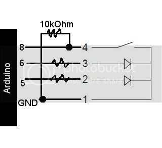

It has 4 pins which acts as "GND" "GREEN" "RED" "Switch"
I have Pin 1 connected to GND, 2 and 3 to two digital output from Arduino. ( at any one time either of the two Digital output is always on ).
Now I want to use the Pin 4 to drive a Digital Input as a switch for some other function.
I am confused as to what wiring should i do. Can I use the Current coming from the LED on pin 2 and 3 to drive the Digital Input that is driven by Pin 4? or is there a better way of doing that? Or is it possible to do so?
Unfortunately, the tenettech web site will not allow access from my country (UK). Can you post a link to a datasheet that is not on that site?
From the diagram you gave, what I think you need to do is to connect pin 4 of the encoder to an Arduino input pin, and enable the internal pullup resistor on that input pin. See http://arduino.cc/en/Tutorial/DigitalPins if you don't know how to do that.
OK, pins A-C-B are standard quadrature encoder contacts, and pins 1 to 4 are as you showed them before. The solution I mentioned in my previous email will work, i.e. encoder pin 4 to Arduino input and internal or external pullup resistor to +5v.
