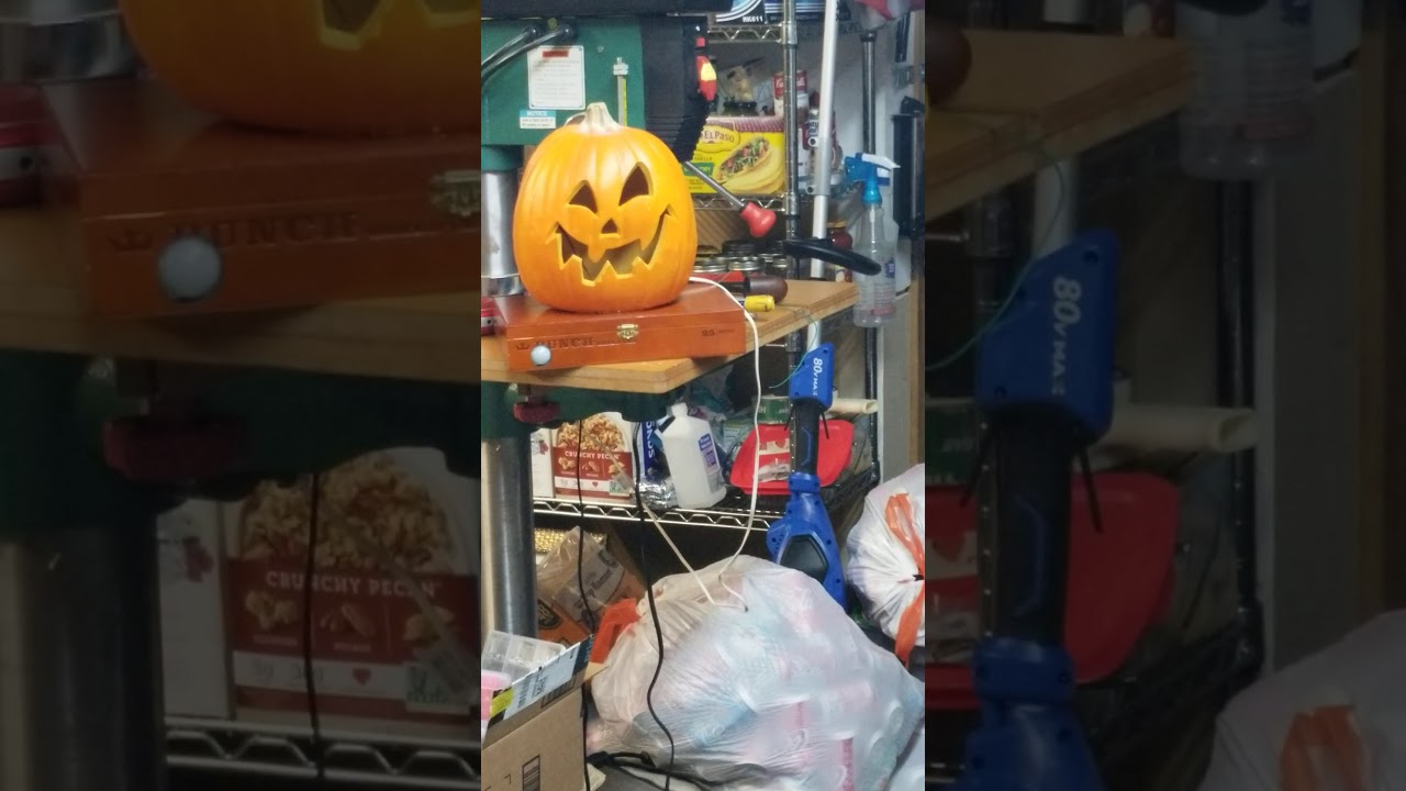

I am building a jack o lantern which will flicker as if there is a candle inside normally. When a PIR sensor sees someone walk up, it will switch to a mode where it plays a spooky voice and synchronizes a flashing red light with the voice. Then it will go back to the flicker mode.
For the lighting I am using a five element strip LED and the FastLED library.
For the sound I am using a DFPlayer min with the DFPlayerMini_Fast library referenced here.
I have been constructing this one piece at a time.
I added the lighting and got the flicker mode working.
I got the red voice light working using a temporary solution that just randomly flashes the light for now.
Then I added the PIR sensor and was able to change modes based on it.
I am now adding the voice player.
Later I will try to synchronize the red voice light to the voice audio.
I am having some trouble with playing the voice while the LEDs are flashing (randomly flashing for now).
When the voice starts to play, the red LEDs begin flashing in a wonky, stuttering sort of way.

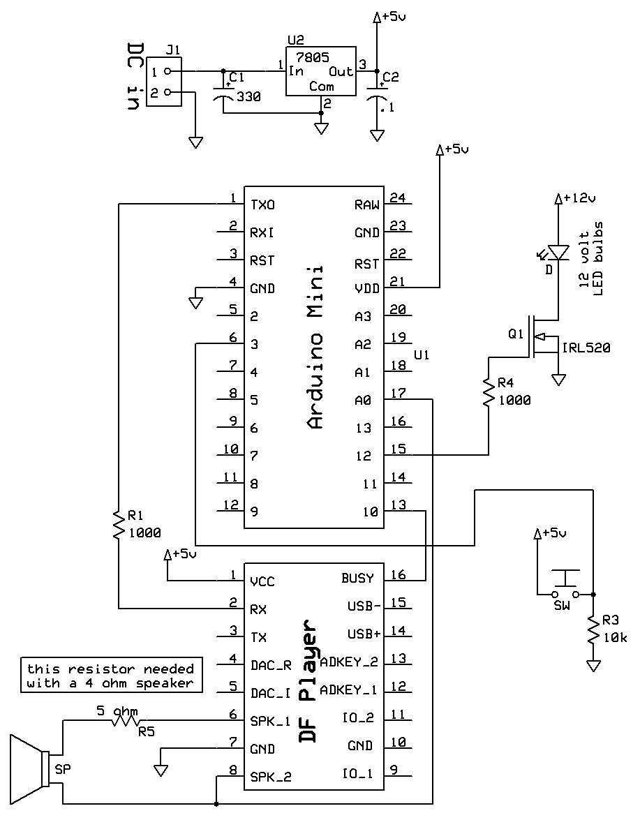

I am currently trying to use the isPlaying() method of the DFPlayerMini_Fast library to determine if the sound clip is still playing. Since this function reads serial data (I think) coming from the DFPlayer mini TX port back to the Arduino, I am wondering if this extra serial data may be interfering with the serial data used to control the LED strip. I have read that those strips need precise timing and I thought this might be the case though I'm not sure.
I believe I have found a different way to tell if the player is still playing the audio or not. I am wondering if it would make more sense to use this type of approach and was hoping that y'all could give me some guidance.
In this schematic you will see that the author connected the busy pin (16) on the player to the Arduino and then monitored that pin to know if it was actively playing audio.
I was thinking this might help my problem, though I truthfully don't even know if the isPlaying() method even uses serial data in the first place.
Yes, ".isPlaying()" requires serial data to be sent to and received from the DFPlayer.
While I haven't tested it myself, I do believe you can use pin 16 for the same purpose as ".isPlaying()".
Power_Broker:
Thank you for verifying the serial situation for .isPlaying(). I think I will just give the pin 16 thing a shot then and see if it helps the situation.
Thanks again.

So, I figured I would let y'all know that I have "finished" this project. My jack o lantern is working pretty much the way that I wanted it to. I may have to tweak the audio tracks that I am using, seal up a light leak, and a few minor things like that, but overall it is done.
Below is a youtube link to it working if you are interested. Please forgive the trash in my basement. Also, the project does look better in real life than on this poorly made video.
Thanks for all of the responses while this was going on.
