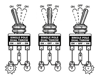

a typical SPDT looks like this
but contractionary you are writing about
momentary would mean: only as long as a mechanical force is applied to the switch the switch goes into position closed
as soon as the switch is released the switch goes back to position opened
or vice versa mechanical force applied position opened
switch released position closed
and a switch that does [ON] OFF [ON] usually looks like this
with including to have a middle-position (= the off-position) where both contacts are opened
You should post a much more precise description what kind of switch you have and how switch-positions are related to
Do you mean a switch that without applying a mechanical force to the lever the switch stays in middle-position off = opened
and depending on the direction of the mechanical forces the contact on the left
or
the contact on the right closes?
but as soon as the lever is released the levver goes back to middle-position?

To me, your two diagrams are electrically identical. In the top one, common (“C”) connects, momentarily in my case, either to normally open “(NO”) or normally closed (“NC”). There are three terminals, just like the bottom diagram. If there IS a relevant difference, it would be an important learning point for me to know.

The differences are
in the real world it looks like that
  • electrical
    This kind of switch would deliver either a infinite enduring
    flap up
    flap up
    flap up
    flap up
    flap up
    or an infinite enduring
    flap down
    flap down
    flap down
    flap down
    flap down
    signal
this one has three positions
left on - middle off - right on
the middle-position is spring-driven
In the real world it looks like this
if it is a momentary switch the signal
flap up would only be given as long as you push the lever up
flap down would only be given as long as you push the lever down
if you release the lever there is
no up-signal / no down-signal
until you push the lever again up or down

This is a beautiful illustration, but looks 180° wrong in exactly the way that the OP mentioned:
Normally, the lever in the switches pushes a contactor on the other side of the pivot point to connect the terminals on the opposite end.
