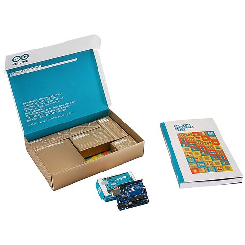

i have the starter kit, that you want to buy. i think its a great start with arduino: you have a lot of things you need (one servo, one motor).
but be careful:
1.) if you havnt build anything with arduino or a similar product, perhaps you should choose something easier to build first?!? i think this analog-mario-game is not a good project to start with!
2.) if you want to build the mario-game exactly as it is, you need 3 servos and maybe a bigger motor, then the motor from the starter kit.

Okay I'm going to buy the stater Kit tonight and i hope it comes next week so i can start putting it together The only thing I don't know about is getting enough power to the Servos! Will having the Uno R3 plugged into the wall give off enough power?
I don't know, but I know they have a servo shield for the Arduino. You might need that. I just finished with the starter kit, but I haven't done much beyond that yet.
in the booklet of the "official" starter kit it is project 10 zoetrope, where a motor-speed is adjusted by a poti.
