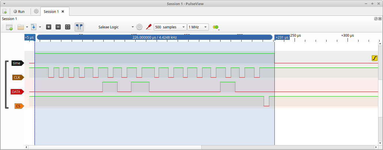

I have been trying to develop the most efficient way to use MAX7219 ICs to run the hours,minutes and seconds for an analog clock. This involved shifting data into the ICs in parallel and then using the LOAD/CS on the individual ICs to pick which one is actually updated.
Unfortunately there don't appear to be any ready made boards in this configuration. There are boards with 4 8X8 dot matrix displays where the ICs are connected as a long shift register. These would require cutting traces and rewiring to use as I did the design. One suggestion was to use them as is with the generic LedControl library support. I figured that it would take 3 times as long to update since 3 ICs would be updated each time.
The question I had was "How bad would that be?". I devised some experiments to answer that question. First I took the simpleClock example and added code to set the built in Led high at the beginning of the clock update and low at the end. I used the built in Led to see if the flash would be noticeable and give some idea of the time. Next I connected a logic analyzer to get the time the built in Led was on as well as the MAX7219 control lines for the seconds update. As can be seen it takes 226usec to do the update.
Next I modified the simpleClock example to use the LedControl library to equivalent function. The code is below.

I then ran the same test with the following results. The long string on zeros in the data is the not updating of the the other two MAX7219s. The time is 672 usec or about 3 times as long as the original design.
logicDsp
logicDsp1330×524 33.7 KB
The worst case time would be when the hours are rolling over which would be about 6 times the seconds update time. (The base time of an update would double when changing rows because you need to turn off the dot in the previous row.) So in the original design worst case would be about 1.356 ms VS 4.032 ms for the generic Led display code. Since both times are insignificant compared to the second between updates using whatever one you are comfortable with should be OK.
Why? You can load all of them serially in a tiny fraction of any interval that the eye can see.
I spent my career working on systems where performance mattered (mid range data processing and supercomputers). I have trouble throwing away performance just because "no one will notice". If you later want to add more function doing the base right to start with will help. As I pointed out in this case it is probably immaterial.
But, it's a trade off. You need three extra pins to do it. Inefficient! Just kidding...
Yes, I think the trade off they made with the serial connections for the MAX7219s was to minimize the pins. This results in more complex software and extra processing. As I said in this case whatever works for you. It was interesting to try the options to see the difference.

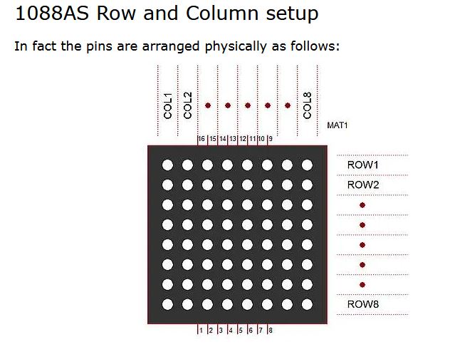

Hi there, I am a little confused trying to wire up my display.. I might be over thinking things..
the 8x8 display, using the 3 displays and your code. From left to right. (data in is to the left ). is the hours, min and seconds ( examples ) and from drawing i see on the net that show the pinout of the display. it appears that your code starts the 1st led at ROW1-COL8, then counts up to ROW8-COL5 is that correct ?
If i am looking at things right. would be easier to explain if i was able to show a lil video.. but i can only post pictures..
1088AS Row_column Disgram
unless i think wrong (not enough experience) shouldn't the counting start with ROW1-COL1 ? wouldn't this be an easier way to do things when wiring up my clock display ?
and last but least.. Should i wire the leds starting with ROWS 1st ? ROW1 or ROW8. sorry if i seem dumber than i started..

The MAX7219 was designed to drive 7 segment displays. The terminology used in the data sheet is segments and digits of the individual 7 segment displays. When used to drive an 8X8 matrix segments maps to columns and digits map to rows.
When I defined lighting individual leds I mapped the digits to groups of rows and the segments to dots in the row.
LED row dot
0 0 0
1 0 1
2 0 2
7 0 7
8 1 0
9 1 1
15 1 7
16 2 0
17 2 1
etc
To find the row for an individual LED divide the LED number by 8. The remainder after dividing by 8 is the dot (col, segment) in the row. Since 8 is a power of 2 the divide and remainder computation can be simple bit operations.
number >> 3 shifts the number 3 bits to the right which is equivalent to dividing by 8
number & 7 turns off all bits except the last 3 and is equivalent to the remainder after dividing by 8
For example 27 = 1B hex = 1 1011 bin
1 1011 >> 3 = 11 or row 3
1 1011 & 111 = 011 or dot 3 (7 = 111 bin)
Different displays can have different mapping of rows and col. The ones I have start in the lower left corner, go across, then to the left side of the next row up. It seem that the one you have maps the col the same but the rows are in reverse order.
