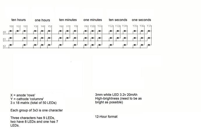

The clock I am building uses a array of LEDs 3 x 18 (3 LEDs per column and 18 per row). The columns are cathode and the rows are anode. The LEDs are 3mm white, 3.2V and 20 mAh. I have the array built, but need help with hooking it up to a Nano. Is it possible to use the pins on the Nano, or will I need shift registers? Which type is best for this project, and what other components would I need?
The array is divided up into six groups of 3x3 LEDs, each representing a character in the display for hours, minutes and seconds. The full array is actually 5 x 18, but the fourth and fifth rows of each character stay lit, so I hooked them together separately.

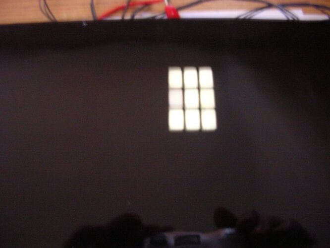

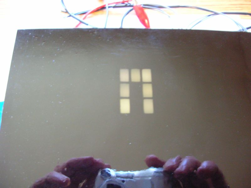

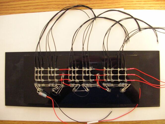

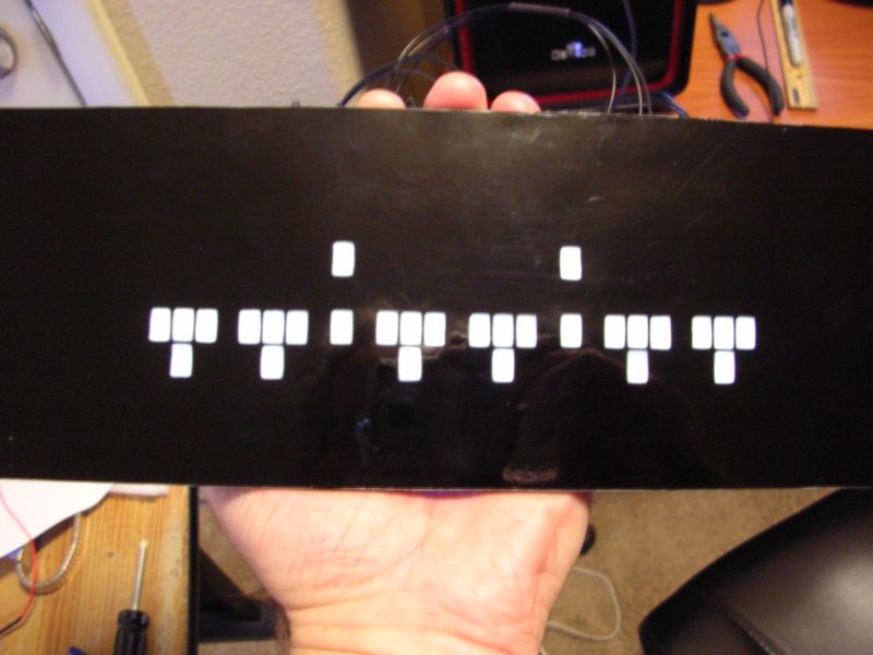

I have attached pictures of the array that I have built so far ( the LED leads on the back of the display are reversed from the schematic since the front of the array isn't visible). The 0 to 9 characters are of the full display. Any help would be greatly appreciated.
Each LED draws 20 mA (from your description). That is basically the maximum of a pin on an Arduino. So you can only have one LED on at a time.
If you make line X0 high, you can only activate one of the LEDs on Y0 .. Y17 at a time by making that line low.
The same applies to most of the Y lines. If you activate Y0 by making it low, you can only activate X0 or X1 or X2 at the same time by making it high.
As said above, you can multiplex and make sure that only one LED is on at a time.

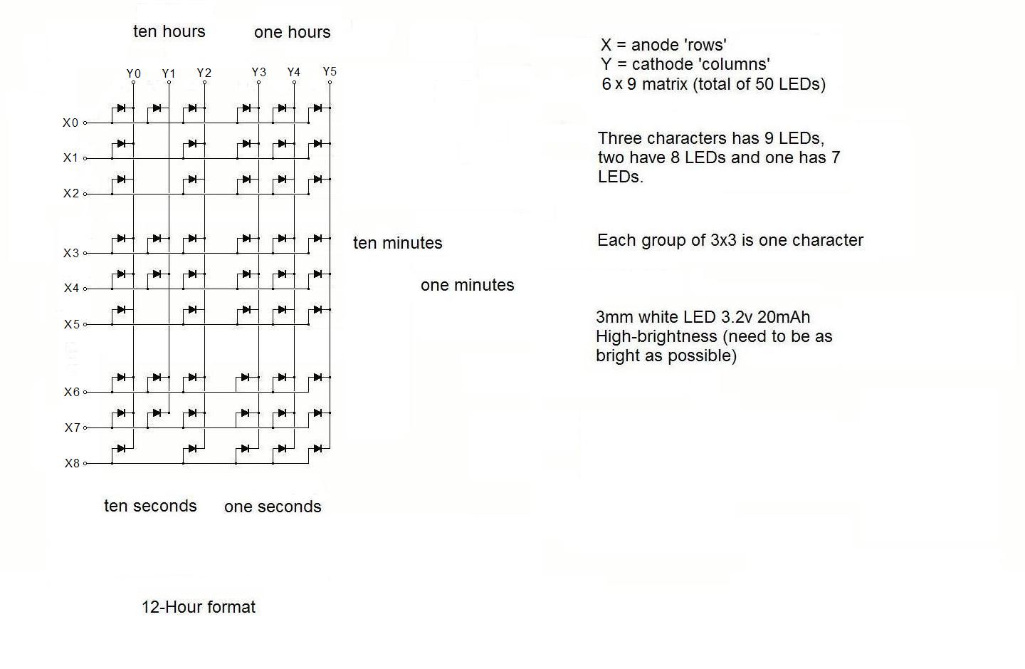

To minimise the number of Arduino outputs, you need to make your matrix as square as possible, electrically speaking. Can you cut those red wires? If so, you can make your matrix into a 6x9 array. This would require 15 Arduino outputs. That uses up every last one available on the Nano, because you can't use digital 0 & 1 (serial lines), or analog 4 & 5 (i2c bus), or analog 6 & 7 (input only). If you need extra buttons for setting the time, you could put these in a resistor ladder attached to analog 6 or 7. You would also need 6 npn transistors for the cathode columns.
In response to post #6; how would I rewire the array to make it 6 x 9? And how would I address the LEDs to create the same layout on the display?

I'll whip up a schematic for you. Give me a little time.

One final question, and I believe I will have the display completed. After originally asking about the changes needed to the array to make it a 6 X 9 grid, I played around with the schematic I originally created, and came up with this design before I saw yours.
Please let me know if it is usable, or if I'm on the wrong track. Picture 1 is of the actual layout of the LEDs, and Picture 2 is a representation what it would look like if built in a physical 6 X 9 array. The transistors (or shift register) would connect to the cathode pins at the top of the array.

Exactly. The OP's matrix was either 3 anodes and 18 cathodes, or 9 anodes and 6 cathodes. max7219 has 8 anodes and 8 cathodes. Any way you wire it, its going to be a bit of a bugger.
ht16k33 has 16 anodes and 8 cathodes. That would work, but seems a bit of a waste.
