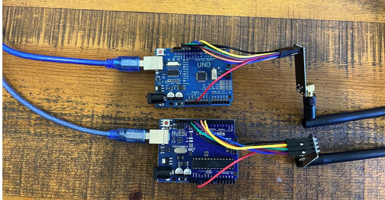

I could use some help identifying why my module or code is not working. I am using two Arduino Uno's rev3.
Here is my pin configuration:
Module --> Arduino uno rev3
GND --> GND (on digital pin side)
Vcc --> 3.3V
Sck --> pin 13
MISO --> pin 12
MOSI --> pin 11
CSN --> pin 10
CE --> pin 9

Also, show a photo of your wiring.
When TX and RX are involved, verify you have the correct direction (one man's tx is another man's rx)
When I send a message using radio.write() I get false, and I am not receiving a message on the receiving side.
Here is my wiring:
My Rx represents the Receiver, and Tx transmitter if that is what you mean by direction.

The majority of problems with these modules reported here are caused by using an inadequate power supply. This is particularly the case when the high power modules are used
The first thing to try is to add an electrolytic capacitor across the power terminals of the RF module as close to them as possible. Do you have any such capacitors ?
To be honest this is not likely to solve the problem but is easy to try. A better solution is to use an external power supply for each RF module
As a halfway house you can use one of these breakout boards powered from a 5V pin on the Arduino

The problem is not an unstable signal but instead, a lack of one. Thanks for the info on how to solve a unstable signal that may be helpful if I can get the radios to actually send and receive.
the image was just for everyone to see my wiring and such, when testing they are at least a foot apart.
Have you tried improving the power supply to the modules ?
ok, I checked this. My MOSI and MISO to the Arduino are correctly wired to the Arduino.
I haven't. Would a battery pack work to test if the issue is insufficient power.

ok I also measured the current and the voltage from the Arduino to the module, is it supposed to have current going while in receive mode but, not receiving any messages. What I got from my readings was a voltage of 3V and current while in Rx mode and not receiving messages of 0.00 mA.
