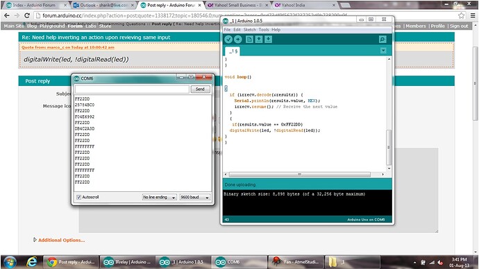

By using "digitalWrite(led, !digitalRead(led))", the led turns on after recieving the code, but wont turn off. (Ultimately, same as before). I have attached the screenshot of serial monitor as well as the edited sketch. Hope you will solve my problem.

I noticed something. My remote transmits FFFFFFFF along with any code if the key is even a bit longpressed. When i press the key & if the code is recieved without FFFFFFFF, the led switched its state. But to again switch the state of led, the code must contain FFFFFFFF. Any other keypress also switches the led state ( as the code is different).
So, FF22DD only turns the led ON, but the led is turned off by any other code. Why so ?
At least the led is turning on & off by remote. But i want it to turn on & off by the same key regardless the key is longpressed or shortpressed.
Any help is appreciated.

FFFFFFFF is the repeat code of the IR NEC protocol
If you keep the key pressed you will get one numeric code followed by one or more FFFFFFFF, depending on how long you keep it pressed.
So just add a line to you code to ignore FFFFFFFF for your application.
