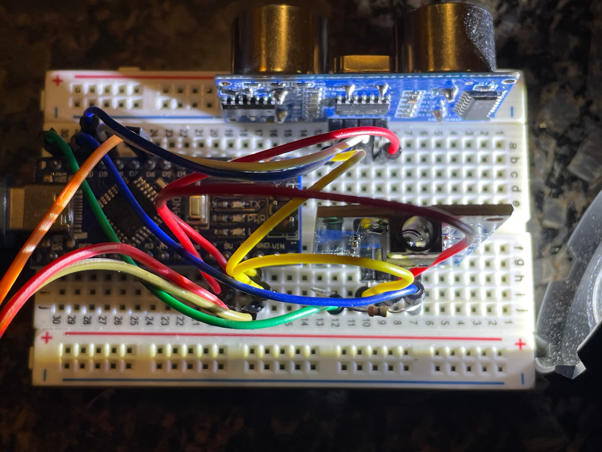

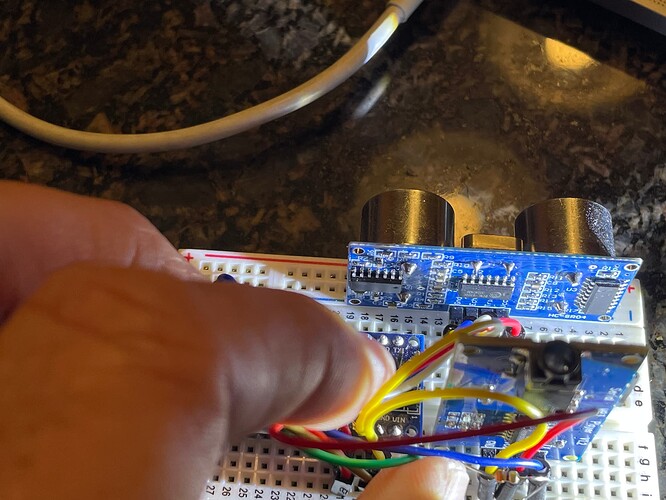

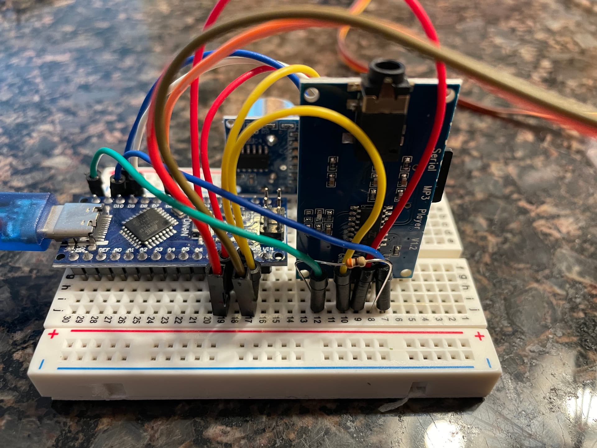

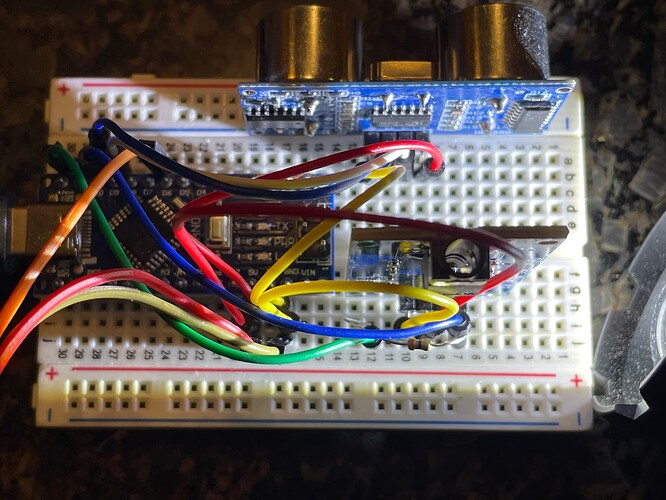

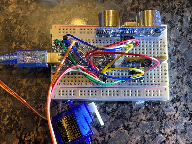

Please show your schematic, at least a simple drawing. Or a table showing all your connections. Or a high resolution photo showing all connections. We need to eliminate a wiring error before looking further.
Thanks for all the responses. Yes I know I should power the servo from a separate power source but this is a small servo and it will be activated infrequently so I was just prototyping it with a single power source at the moment. Ill use a separate source in the final project
I tried to make a schematic of the wiring but I only have access to Tinkercad and the don't have an MP3 player in the parts choices. I took some pictures. Obviously harder to see the wiring this way so I apologize but if this help and thanks in advance for taking a look.

The Catalex-type MP3 player (pics in No.9) is not a DFPlayer.
It will not work with the DFPlayer library.

But your image shows some other board. Perhaps Nano?

That's clearly labeled 'Nano', not a 'Mini' that you said.
What made you think this was a DFR MP3 player?
Try the library from this thead.
And it appears to be a clone.
Yes sorry, That was a mistype. Its an arduino type nano
