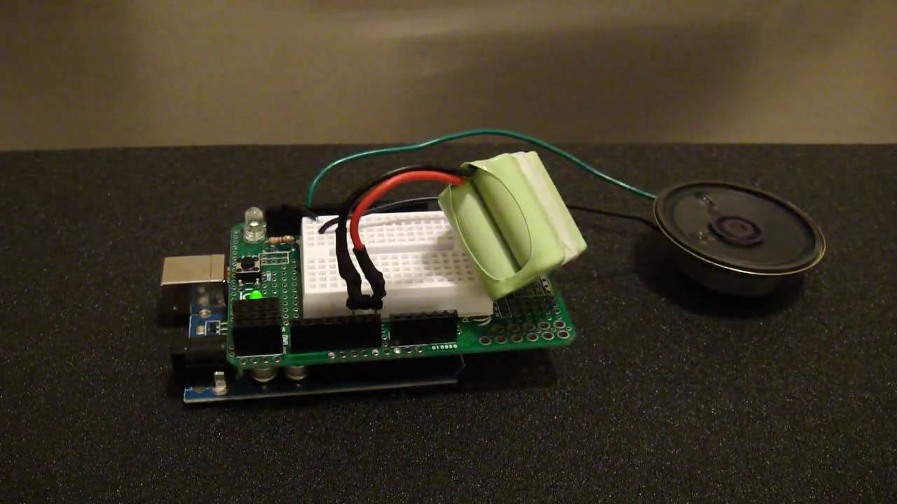

I finished the short clip of the MacGyver theme. I think it sounds pretty close to the original theme song.
char *song = "MacGyver:d=4,o=6,b=150:8b4,8e5,8a5,8b5,a5,8e5,8b4,8p,8e5,8a5,8b5,8a5,8e5,b4,8p,8e5,8a5,8b5,a5,8e5,8b4,8p,8a5,8d,8c,8d,8c,8b5,8a5,8b4,8e5,8a5,8b5,a5,8e5,8b4,8p,8e5,8a5,8b5,8a5,8e5,b4,8p,8e5,8a5,8b5,a5,8e5,8b4,8p,8a5,8d,8c,8d,8c,8b5,8a5,b5,8p,2b5,8p,b5,8p,a5,d.,b5,8p,2b5,8p,8b5,8p,2a5,p,8c,8c,8c,8c,8c,8c,2b5,16p,8f#5,8a5,8p,2g5,8p,8c,8c,8p,b5,8a5,8b5,8a5,8g5,8p,e,2a5,16p,8c,8c,8p,2b5,8p,8f#5,8a5,8p,2g5,8p,8c,8c,8p,4b5,8a5,8b5,8a5,8g5,8p,4e,2a5,2b5,32p,8c,8b5,8a5,c,8b5,8a5,8d,8c,8b5,d,8c,8b5,e,8d,8e,f#,b5,g,8p,f#,f,b5,8g,8e,8b5,8f#,8d,8a5,8e,8c,8g5,8d,8b5,8g5,8c,8e5,8b5,8d5,8c,8b5,8a5,8g5,a#5,a5,8g,8g5,8d,8g5,8d#,8d#5,8a#5,8a5,8g5,8g4,8d5,8g4,8d#5,8g4,8a#4,8a4,8g4,8g4,8g4,8g4,8g4,8g4,8g4";
Tell me what you guys think.
XD
Played around with this today - WAY too much fun!!
Somebody should put this in the playground (with the macgyver theme added)...
:slight_smile:
not to toss this thread off topic, but cr0sh, check your PM!
I posted a video of my setup playing the MacGyver theme.
