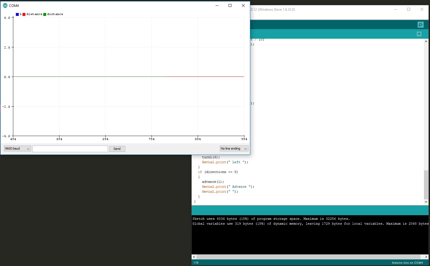

aarg:
What about the serial prints? Does it ever print, "Advance"?
Not that i can see no. But i'm new to Arduino so i don't really get how it all works.. :confused:
The Serial Monitor doesn't show anything at all, but in the Serial Plotter it loops the following:
Reverse, F, distance
L, distance, distance
R, distance, distance
(attached img showing it)
