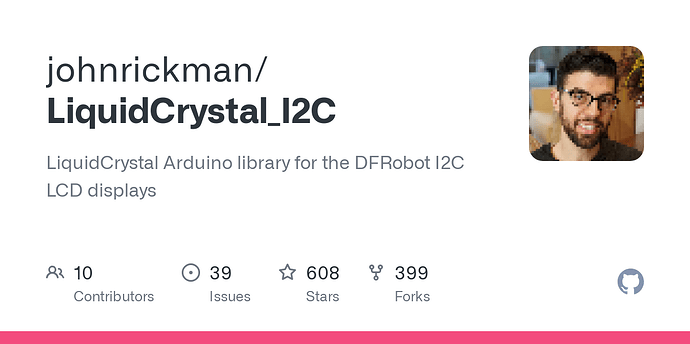

Post a link where you get the LCD I2C library.
This ( #include <LiquidCrystal_I2C.h> )

I installed if from the library of IDE.

For those of you saying that the constructor and code for "LiquidCrystal_I2C" is incorrect, keep in mind that there are multiple libraries out there that have a LiquidCrystal_I2C class.
The header files and constructor for LiquidCrystal_I2C class and code API calls appear to be from fm's newLiquidCrystal library not the LiquidCrystal_I2C library available from the IDE library manager.
Because there are multiple libraries out there with a LiquidCrystal_I2C class, and they work differently and have different capabilities, it can be quite confusing.
The advantage of newLiquidCrystal LiquidCrystal_I2C is it works with any I2C backpack,
The disadvantage of the newLiquidCrystal is the pin mappings specified must match the backpack you have, if not, nothing works.
The advantage of LiquidCrystal_I2C LiquidCrystal_I2C is that it is simpler,
the disadvantage is it only works with 1 of the backpack designs and can not be configured.
If the backpack uses a different pin mapping than the library was hard coded for, it won't work unless code changes are made to match the backpack.
To add to the mix of confusion, there are multiple LiquidCrytsal_I2C libraries out there in addition to the one available in the IDE library manager.
Also, if you install both newLiquidCrystal and LiquidCrystal_I2C the IDE can get can get confused and can potentially not pull in the one you want depending on what other header files you include in your sketch.
At this point, neither the newLIquidCrystal nor the LiquidCrystal_I2C available in the IDE library manager are maintained.
In years past, I was involved with and worked on the code in both libraries.
Because of this confusion,
I created the hd44780 library make things simpler.
It is available in the IDE library manager and offers a plug an play experience as it can auto locate the I2C address and auto detect the pin mapping used between the PCF8574 chip and LCD pins.
i.e. it should "just work" without having to configure anything
The hd44780 library hd44780_I2Cexp i/o class also includes a diagnostic tool to verify the h/w and connections.
My suggestion would be to switch over to using the hd44780 library and the hd44780_I2Cexp i/o class.
The library has a wiki and even includes information about how to modify sketch code from other LCD libraries like newLiquidCrystal and LiquidCrystal_I2C to work with the hd44780_I2Cexp i/o class.
