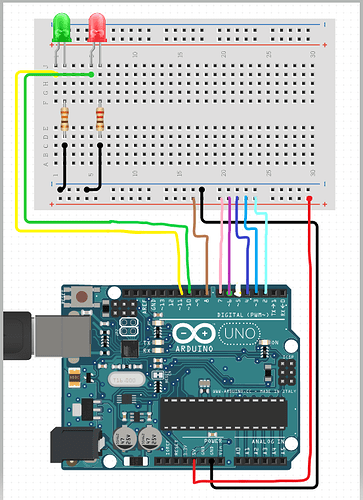

I make a code that you have 3 wires called correcto1, correcto2 and correcto3, you need to "cut them" in certain order to light up a green led, if you don't "cut them" in the correct order, it will turn on a red led. My problem is, whatever i do the correct order or not, it always turn on the red led.
i'm using arduino uno
my code have other 3 wires called fallo1, fallo2 and fallo3. if you "cut" one of them, It will turn on the red led

Hello daclica
Post the schematic, too.
What are the differences between the input signals 'fallo' and 'correcto'?
done
Where ?
I can´t see a schematic.
now i uploaded the correct image

You appear to have your wires connected between the INPUT pins and +5V. If you do that you must have pull-down resistors on the INPUT pins or the inputs will float when you 'cut' the wire.
I would change the pins to INPUT_PULLUP to enable the internal pull-up resistors. Then, connect the 'wires' between the pins and GROUND. When you 'cut' the wire, the pull-up resistor will cause the pin to read HIGH. Until you 'cut' the wire the GROUND will cause the pin to read LOW.
