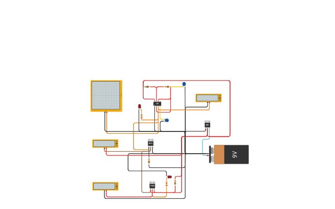

I need your help, I have a Arduino Due with 3.3v, I need to power up/switching with Arduino on/off a GSM/3G module 5230E from Adafruit with 3.3v too. I want to switch on the GSM/3G modem every 2 hours for 10 minutes, because when run on battery it will drain the battery. So to extend the lifetime on battery, I switch the module on, read an SMS or sending via HTTP the GPS position, then power off. That's the plan.
I'm testing, researching for a long time (I haven't much spare time...) for switching this module..
Yes I "could" switch it on with an relais... sure, but it is big and loud and not much fun...
Lately I have tried a optocoupler 4N25 with no success...
Now I'm trying a n-channel mosfet to a p-channel mosfet...
I made a Tinkercad circuit to test everything, It "should" work, but not on a real board.
My Mosfets are a IRL2703 and a SUP53P06-20... I cannot get the p-channel mosfet to work properly, the n-channel works fine, until I add the p-channel mosfet.
The n-channel mosfet should be ok, it is a logic level mosfet, the p-channel mosfet has a low VGS value too, so it should work...
Why the p-channel mosfet? Because the ground for the module is connected to the chassis and I cannot disconnect it from the common battery (it is a micro usb cable)... So I need to switch on the "high side", ie. source instead of ground.
Can somebody help??

We need to see a complete proper circuit diagram for more advice, and not some tinkercad or Fritzing crap.
Leo..

A P-channel fet with it's source connected to 3.3volt can be directly switched with 3.3volt logic.
You might want to study this page.
It explains everything about switching high/low side with same or different supply voltages.
Not sure if you can power the Due just from 3.3volt. Some of it's circuits are powered with 5volt.
A 5volt supply for the MCU and GSM charger (with LiPo battery) seems more logical.
This get extremely confusing, and impossible for us to solve without a circuit diagram.
Pen/paper works the fastest.
Leo..

Ok, hand drawn, please don't laugh (this is why I try to draw everything in Tinkercad/KiCad):
Found a solution, instead of switching power, I switch the buck converter!!!
![|500x305](https://www.predl.cc/images/Auto GPS.png)
The used buck converter LM2596S has a pin 5, which I use to soft turn off the buck converter.
The only little thing is, the "standby" buck converter uses 80mA...
a) the Arduino Due is running on the internal regulator 5v... (wanted to use the better buck converter for duration power, better efficiency...)
b) the standby power of 80mA is not that good?!
Suggestions?
