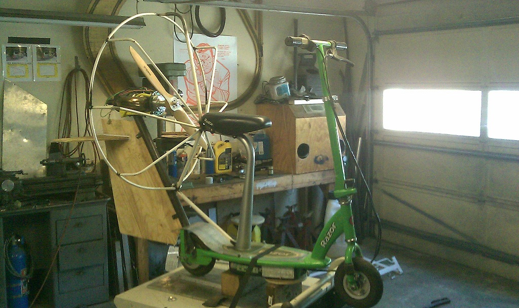

Thanks for all your help. Here's the van-
I'd really like to automate some functions on the van. I ordered an Arduino, it will be here tomorrow, time to learn something new. There's just too much capability here.

Here's the scooter-
I was driving around the neighborhood looking for my helmet and fire suit.
Thanks again!
Cool!

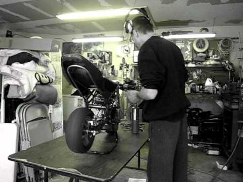

Hey guys, that scooter was extremely unsafe! It almost killed me and then tried to take out my son. We had to put it down, it was evil. We got a racing bike and coupled the turbine directly to the rear wheels via a special gearbox-
I could use all your help again. I'd like to monitor the speed of the turbine output shaft (about 17,000 rpm) and set it up so when I approach a target rpm the servo output signal that controls the throttle on the turbine will start to power down.
There's 2 shafts in this turbine, the main shaft spins 160,000 and is monitored by the turbines controller. the second shaft is driven by a second dedicated turbine wheel, this shaft can be used to power whatever you want with the proper gearing. The thing is, they relied heavily on a huge airplane propeller to keep the power turbine of this thing from overspeeding and it worked well. The prop would go supersonic at the tips and cause all kinds of drag before it got close to the turbines burst rpm.
the actual rpm of the power turbine is 60,000, it goes through a 3.43:1 reduction then there's the chain drive with about a 10:1 reduction. I figure picking up the rpm off the intermediate shaft would be best as it spins slower than 60,000. I could also pick up the power turbine speed by monitoring rear wheel speed but I would have to correct the program whenever i changed gear ratios.
can anyone give me a clue as to where the best place to put a speed sensor would be? writing programs isn't easy for me but when it comes to sensors and transducers and signal exchange I can get it done.

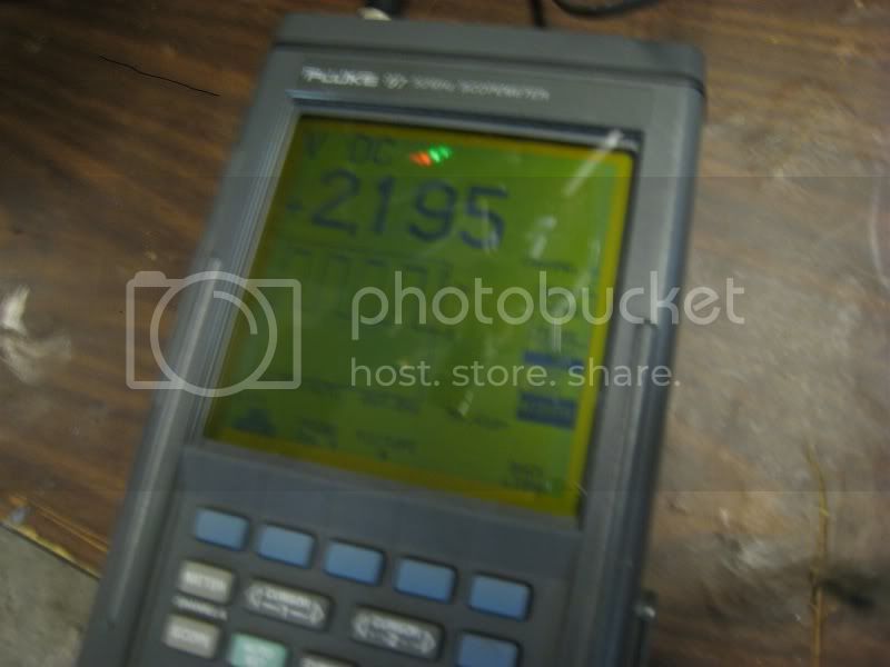

I got a sensor configured-
I know how to make good signals, i just need help with the code!

update- the scooter aka WOAT (waste of a turbine) almost killed me and my son so I ripped everything out and used the parts to build this little bike. I made a new gearbox for the turbine with gears from an angle grinder. This thing is fast and much safer.
