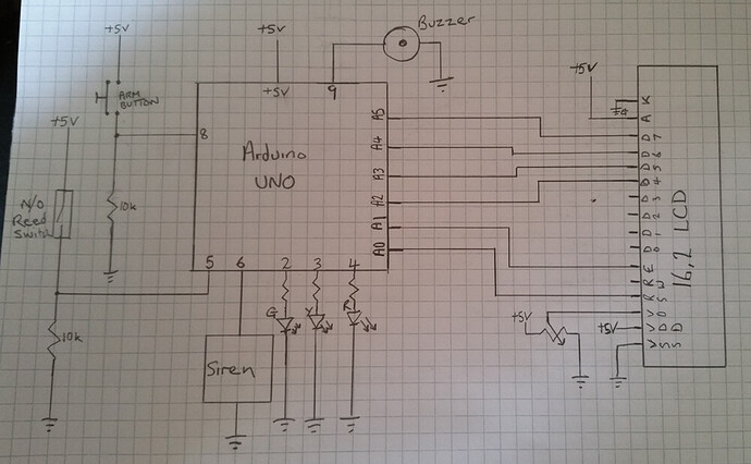

Hi All,
I am wanting to make an alarm for my shed.
I want it to consist of 16,2 LCD, Arduino UNO, Siren, Buzzer, 3 LED's, A switch to Arm/Disarm (Later to be replaced with an RFID Reader, Magnetic Reed Switch on door etc.
I previously started a thread asking for help on the schematic and code but I have been working hard today working on the circuit and I think I have came up with something that will suit my needs.
I really am struggling to get my head around the coding especially loops. I just can't seem to come with a code at all.
Basically when unit is first powered up, I want the LCD screen to say something on the top line and say "Alarm Disabled" on the bottom line. I have managed that... Just!
When the button is pressed I want a delay of 15 seconds and a beep from the buzzer every second to give me time to exit the shed. If the door isn't closed after 15 seconds, I want the alarm to sound.
If the door is shut, I want the alarm to be armed. Once the door is opened, I want the same 15 seconds delay to press the button again to disarm the alarm.
Green LED = Alarm Disarmed
Yellow LED = Countdown
Red LED = Alarm Armed.
I have the LCD Connected to the analog pins to free up some digital pins for the future when I plan to add RFID.
I have started writing the code but I have no idea what I am doing. I am new to all this lol.

You aren't going to be popular with your neighbours.
You set Siren high (the siren presumably sounds) but nowhere do you set it low.
How are you going to stop it?

Right I have stopped being so lazy and started to write the code myself with great success.
Just one question. How can I make the beeper bleep every second for 15 seconds (entry delay)?
I need it to beep 15 seconds then the alarm goes off or beep until the alarm is disabled.

Look at the 'Blink without delay' example either in this website (examples page) or in the IDE.
Also see Demonstration code for several things at the same time - Project Guidance - Arduino Forum for further guidance.

First of all, I suggest you use a loops for your on / off siren, which yes, will may you really popular with the neighbours. Try something like
for (int i=o; i<10; i++) {
digitalWrite(buzz, HIGH);
digitalWrite(buzz, LOW);
Using some maths, with this basic method you can work out times like you 15 seconds. Good to also google some info on the use of millis for timing.

Pseudo code:
if (millis() - millisStart =>15000){
STOP!
blink without delay is a hard thing to grasp as it seems you have to write code for the thing you care least about.

once you can wrap your head around the fact that blink without delay has to juggle 3 things,
if the condition was the same as before
if the duration has elapsed
and set the last condition
then, it will start to make sense.
