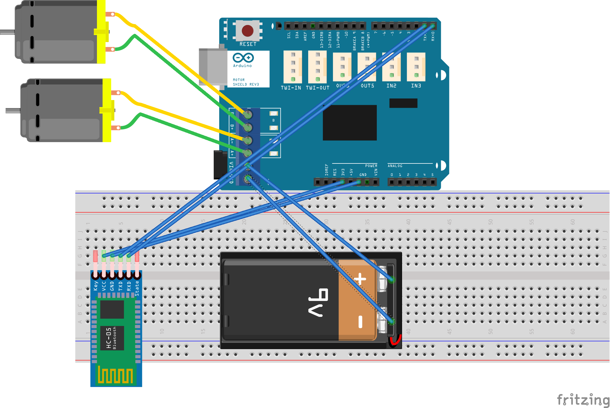

I've got an Arduino Genuino R3, HC-05 bluetooth system, Motor shield Arduino official, and two RC Motor.
I want to control my cars (all of the motor), with my phone with the bluetooth but i try some project but always fails :

How do you have the phone connected to the Arduino? You're the only one who knows what you have set up. If you want our help with it you're going to have to describe it all to us. Don't be afraid to be verbose. Get it all out there. Pictures are good too. Draw a schematic. But get the details out to us somehow.
Here is a schema (I know it's not great but...).
Here it is :

You don't need the Software Serial library if you're using the pins 0 and 1 from the Arduino, the Arduino will automatically see that you're using another 'Serial'. Also the code won't upload if you have your wires connected to 0 and 1 on the arduino, remove those wires while you're uploading the code and then put them back in place.
thank you i will try with the single quote !
Here is a pictureof my robot and my code (and it's not work ).

       digitalWrite(8, HIGH);   //Disengage the Brake for Channel B
     if(data == '4')
  //turn
       digitalWrite(12, LOW);  //Establishes backward direction of Channel A
       digitalWrite(9, HIGH);   //Disengage the Brake for Channel A
       digitalWrite(13, LOW);  //Establishes backward direction of Channel B
       digitalWrite(8, LOW);   //Disengage the Brake for Channel B
     if(data == '5')
  //STOP ALL
and it's not work
Whatever that means.
AWOL:
The motor dont move !
Thank you.
You have a simple test sketch that you wrote first, and uses the same setup(), and simply turns the motors on forward for five seconds, stops for five seconds and reverses for five seconds.
Does that work?
Yes it's work,
it's doens't work when i want to use the HC-05 (but i do a basic project with a led and the bluetooth module and it's work).
