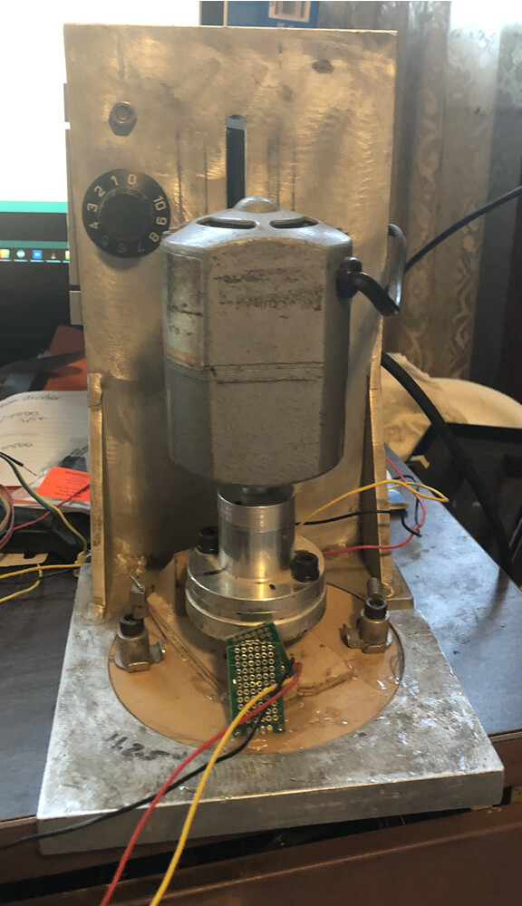

My tachometer project is for a 2-cycle race engine. The tach will
measure the rpm using several different methods: (1). Capacitive
pick-up attached to the spark plug wire. I have 2 methods to clean
up the ringing associated with the coil. (2). A tach source wire from
the CDI ignition. (3). A motorized Hall Effect test stand. I also have
an ignition coil test stand.

I have tested many individual parts of my tach, but the math and the
circuit to mask the coil ringing are still on my todo list.
I want to get my math to work with a single cycle first, then record
several cycles, determine an average, and calculate the rpm.

I am using an old ignition test stand (with a variable speed control) to test the
mega2560's timer4 and my initial results were not as expected. The results were
values of less than a byte (160 -240).
My next test I measured the duration of rotation of the ignition test stand at
lowest speed, ~26ms.
26ms => .026ms.
.026/.0000000625ns = 416,000 clock cycles.
416,000 x 64 prescaler = 6,500 counts @ ICRx register.
So, using the code below, I expected 6500 from ICR4, but I recorded ~160 to 240.
?? Does the Serial Library effect the entire program, and not just timer1??
?? I thought timer4 was independent of the program flow ??
Thanks
Bill M.
