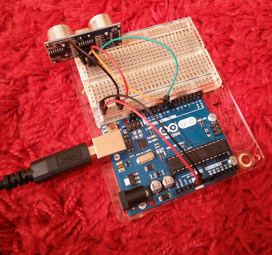

i'm very new to Arduino and am trying to achieve a simple circuit whereby an ultrasonic sensor controls the brightness of an LED light.
I have been TRAWLING the internet for this very simple tutorial and have had no luck. I'm not inept with technology and the internet, I just have only found people who have set up the circuit but need help with the coding or the final stages or whatever.
Arduino has become incredibly infuriating for me because I know this is such a simple setup and I just can't achieve it. I'm sorry if this has been asked and answered before but any previous posts i've found have not been helpful or i just havent been able to understand.
I have set up the arduino so that the ultrasonic sensor can measure how far away objects are.
The board is an Arduino Uno.
The sensor is a HC-SR04 ultrasonic sensor
Pic is the setup
Can you do the things separately?
I mean:
Can you make a sketch to control the brightness of a LED?
Can you make a sketch to read an ultrasonic sensor?
Once you can do what Rob suggests, you could get the US range reading, convert to 0-255 using map(), then use that value to control the LED brightness with PWM.
It'll be good practice if you do it yourself. Don't just look for someone else's code that does exactly what you want, or you'll learn very little.

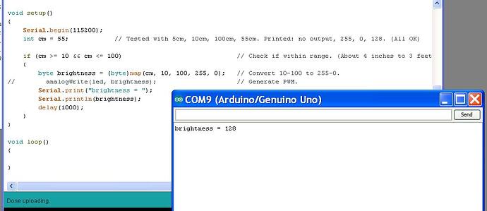

Taking an ultrasonic range reading and generating PWM from a pin are both very simple concepts, and there are examples of both provided with the IDE. The "Ping" sketch for ultrasonic ranging, (>Examples >Sensors >Ping) and the "Fading" sketch for controlling LED brightness, (>Examples >Analog >Fading).
Just check out those examples, then have a shot at it. If you run into trouble, post your attempt at the code here, and we'll help you sort out the bugs to get it working.
You could maybe determine maximum and minimum ranges that you want the US range to affect the LED, set up an 'if' statement to reject values outside that range, then use 'map()' to convert values within that range to 0-255 for the PWM.
For instance, if you were to select the range of 10cm to 100cm, you could use:-
// Do ultrasonic range procedure here, then:-
if(rangeIncm >= 10 && rangeIncm <= 100)
    pwmVal = map(rangeIncm, 10,100,255,0);  // Convert 10-100 to 255-0.
    analogWrite(pwmPin, pwmVal);            // Generate PWM.
With those values, the LED would be at full brightness at 10cm, just off at 100cm, or somewhere in between.
(Similar thing for inches.)
Edit: Aside from the actual ranging, and selecting the values, I've just about written it for you. :smiley:

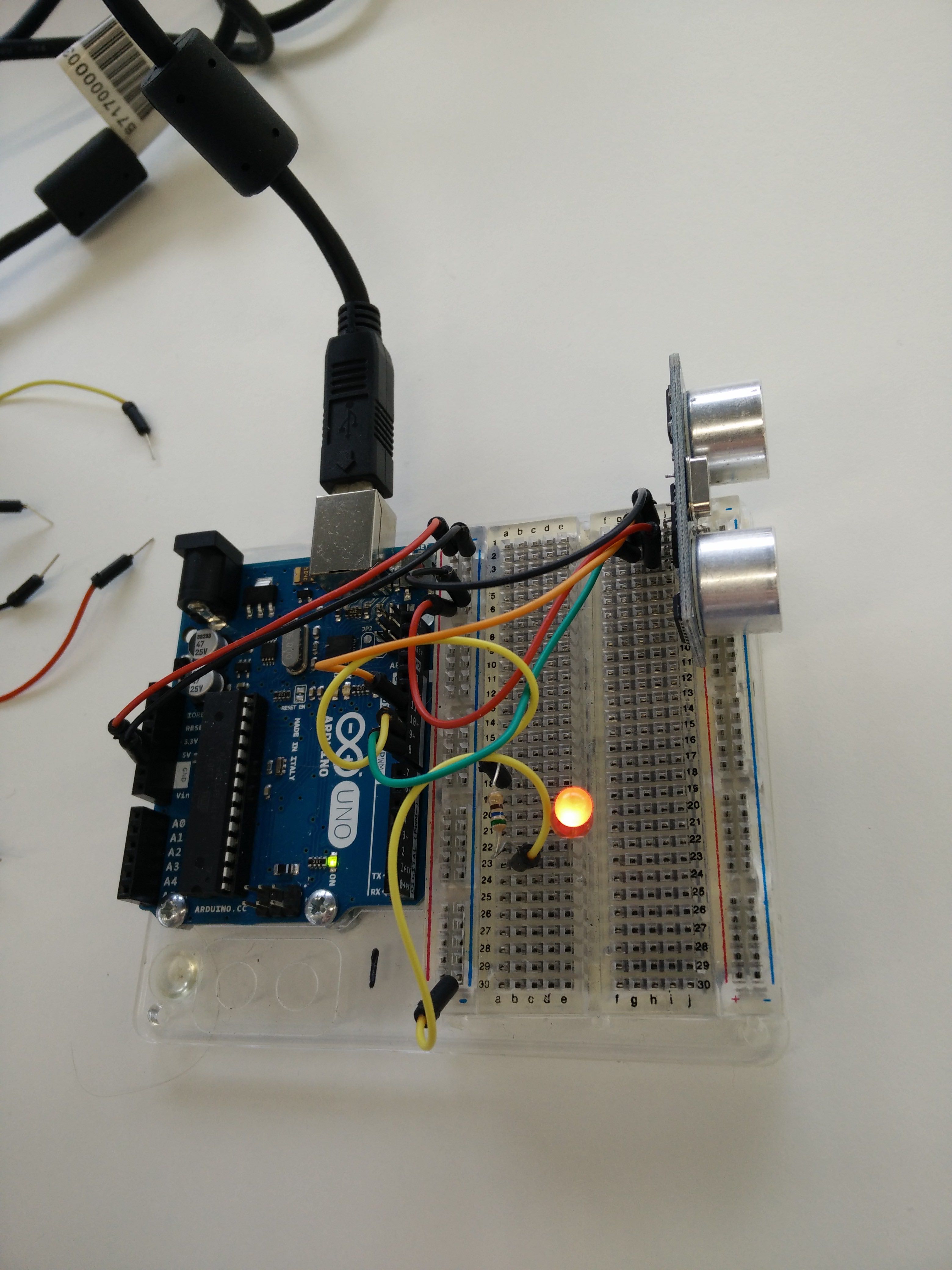

what i desired was for the measurements to be displayed on the serial monitor as well as changing the intensity of the LED light (the closer an object is, the more intense the light is)
However, with this code, the LED light just constantly fluctuates in regards to intensity, and doesn't really change depending on how close an object is.
also, the readings from the sensor seem inaccurate at times. as i was testing the distance measurements as i walked closer to the sensor, it would sometimes read measurements like "942in, 2404cm". I have tried a different HC-SR04 sensor and the same occurs. Is this normal for the sensor, and would there be any way to make the readings more accurate?
Further down the line (if i can get accurate measurement readings), I would like multiple sensors to detect humans, and the LED light would change depending on whichever sensor reads the closest measurement, but i guess we'll cross that bridge when we come to it...... :smiley:
Help sorting out the code above is the main priority atm.
You're getting there.....
You didn't need to add an extra 'analogWrite()', directly writing the duration to the PWM pin. It makes the following conditional useless, as well as writing an out-of-range value to the PWM pin.
Think about exactly what's happening -
1. You do a ping. (OK so far)
2. You measure the pulse. (Still OK)
3. You convert it to inches and cm. (OK, but one or the other would be better)
4. You spend 10 to 20 mS doing serial prints. (Serial prints are OK, but they do take 10-20mS at 9600 baud, so not now.)
5. You write the duration in microseconds directly to the PWM, (LED) pin. (This is bad, especially since that value is likely to be in the thousands, whereas a PWM pin expects a value between 0 and 255. A random value is being written when you don't want to write anything at all to the PWM pin yet.)
6. Now you wait for 100mS before determining if the target is within range. (If the target is moving, during this total period of 110 to 120mS it will have moved closer or further away, so the LED brightness won't end up corresponding exactly to the distance. Since the most important things are the operation of the ping sensor and the LED, give those operations priority for best results, and do them one immediately after the other.)
7. Finally, you now do the conditional which in turn determines whether or not you will even set a PWM value, and what that value will be (after mapping to 0-255). (Except that you've already written a wrong value to the PWM (LED) pin 100mS ago, so you're seeing a blend of the right value and the wrong value in the LED brightness, flickering at a bit under 10Hz.)
While it doesn't hurt, it's probably a better idea to use a separate variable for the LED brightness, too, rather than 'duration'. If nothing else, then it can be given a more meaningful name, like "brightness". :slight_smile:
Generally, when programming, it's not a good idea to use 'delay()', either. It's far better to use 'millis()'-based timing. There's a good example of that basic method in the "Blink" example. For now, though, I'll leave it in, but move it to a more approriate place.
Another point - do you really need the measurement in both inches and centimeters? It's better to just work with one unit - whatever you usually use in your country. (Not a necessity, just a suggestion. :slight_smile: )
Anyway, having said all of that, (just to help you understand - I'm not having a shot at you), here's a re-arranged and repaired version of the code. It's 4am and I'm tired but couldn't sleep, so hopefully I got it right.)
Oh, I just noticed. You declared these twice, both globally at the top and locally in the 'loop()' function.:-
long duration, inches, cm;
Once, in 'loop()', is enough, and I changed 'cm' and 'inches' to int, since they won't be big enough to need a long.
Anyway, see how this goes:-

I appreciate you tidying up and re-writing the code for me so much, thank you. However, when i tested it out, the LED initially was off, but as I put an object in front of the sensor, the light turned on and stayed on, never dimming or anything.
Also, I looked at NewPing and found arduino's example code for a sensor (Sample NewPing Sketch). I uploaded the code and the results are in the screenshot. :frowning:
This is some code I found including median, however, there is no "ping_median()" written in the code so i don't think it's correct. Plus, I got a compiling error when verifying the code anyway.

I'm not exactly sure why the code I wrote yesterday fails to vary the LED brightness. The LED should be at full brightness at 10cm, right off at 100cm, and varying degrees of brightness in between.
My one and only ping sensor is permanently attached to my robot, but I'll run some leads from it in the morning and see why the code fails. Maybe I've overlooked something.
For now, I just tested the maths - the 10cm to 100cm conditional and the 'map()' function. I replaced the 'analogWrite()' with a print to the serial monitor, displaying the "brightness" value, and got correct readings. I manually 'plugged in' values of 5cm, 10cm, 100cm and 55cm, and the values printed to the serial monitor were exactly as expected:-
5cm: no output
10cm: brightness = 255
100cm: brightness = 0
55cm: brightness = 128
So that part of the code's OK, and doing what it should. I'll do that test in the morning and see what's going wrong. I can't see anything in the rest of the code that should fail. I'm puzzled.
A screenshot of my test code and result:-

So I think a clear photo of your setup is called for at this point.
Edit: The full setup as it stands now, including the LED.
(Your first photo only showed the 'ping' sensor.)

pics attached show my setup
