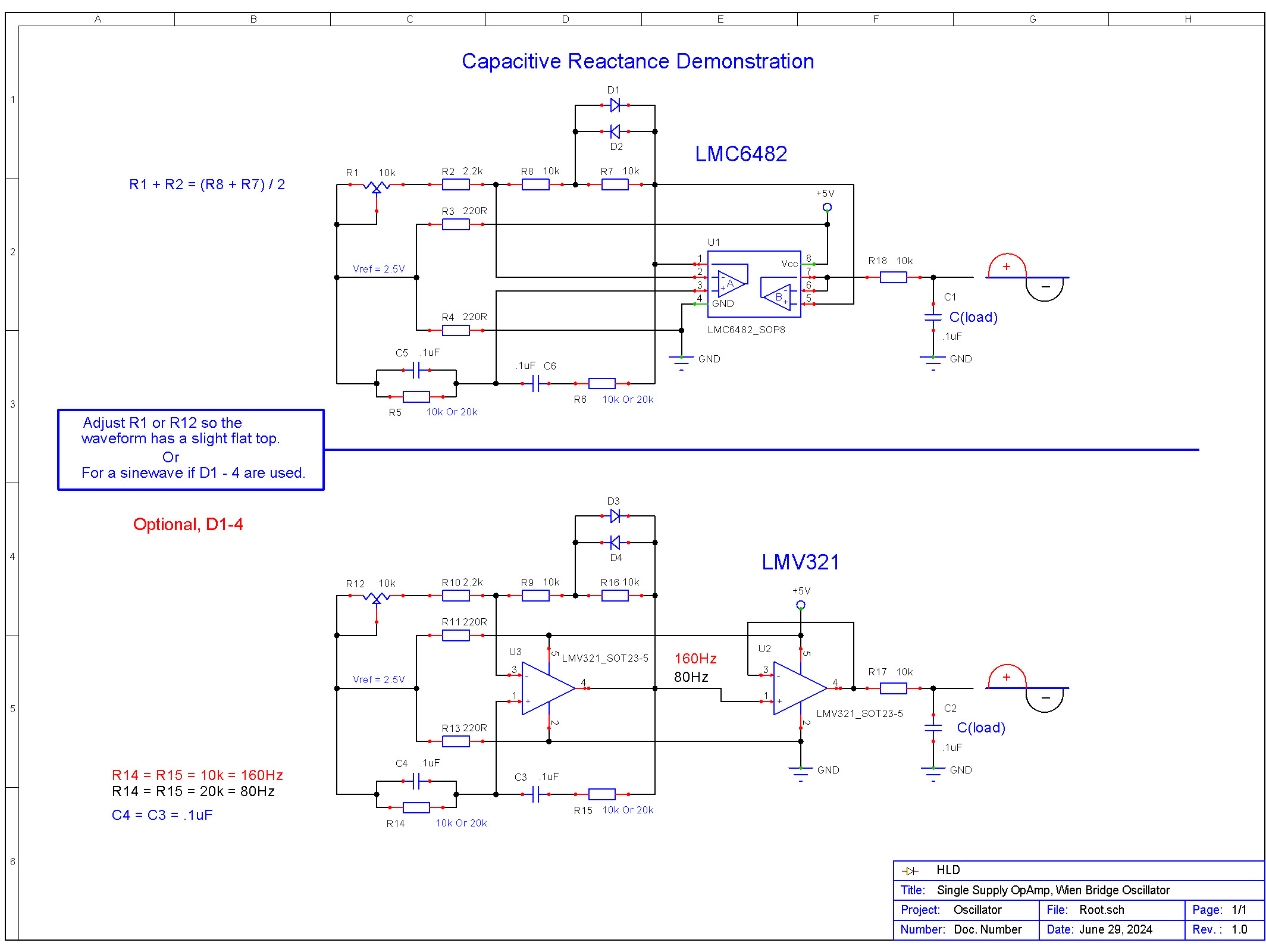

Need your help guys in generating ac sine wave
A 555 timer comes to mind.
  • Will you be the person demonstrating this or will students be doing the measurements in different groups ?
  • Will the circuit be: solderless breadboarded, point to point wired/prototyped or will this made into single use PCB ?
EDIT
Updated schematic, two (2) options for the Op-Amps.
Thanks Larry I appreciate your valuable time alot.
I will try to build this Circuit myself on Breadboard and if it works as attened, I will demonstrate it to my students.
I guess the DVM will reads small ampere values in range of 0.5 to 1 miliampere ?
  • The LMV321 (order the SOT23-5 version) is a small I.C. to solder.
