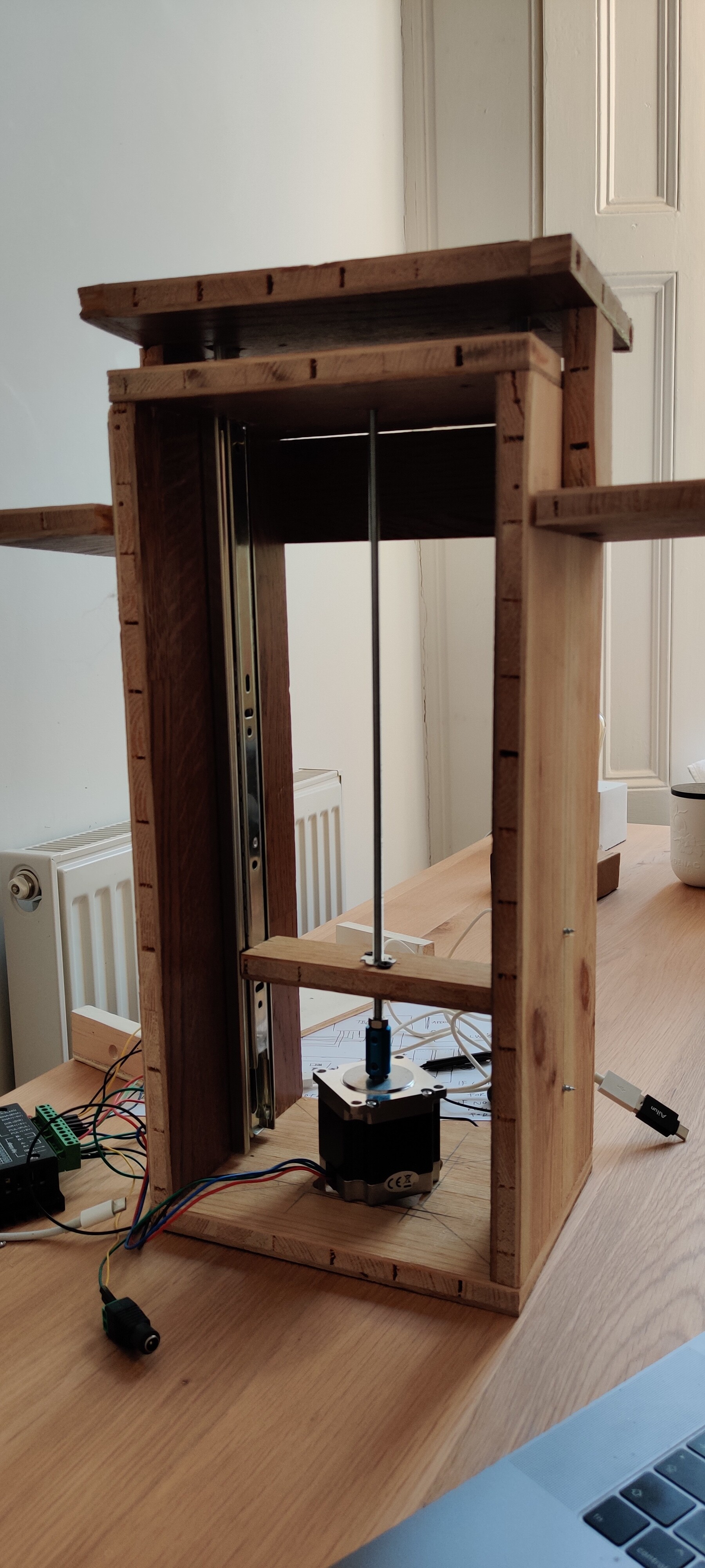

BTW im building a lift which will raise and lower my loudspeakers behind the sofa when the computer next to the sofa is on and off... will upload photos later on when the contraption is done... (tomorrow)
