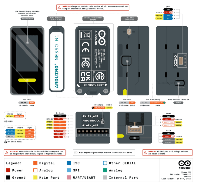

Nesso N1 (online) User Manual Keyword conflict
Conflicting keywords... KEY1/KEY2 also in pinout drawing.
https://docs.arduino.cc/tutorials/nesso-n1/user-manual/#buttons-and-led
The answer to the above is "KEY1/KEY2" (BTN1/BTN2 - not defined)
... BUT...
the sketch for "buttons.ino" is this... from the online Nesso N1 User Manual...
  pinMode(KEY1, INPUT_PULLUP);
  pinMode(KEY2, INPUT_PULLUP);

However, without...
#include <M5Unified.h>
#include <Arduino_Nesso_N1.h>
The sketch does not compile, and complains of "KEY1/KEY2" and some incorrect definition (it takes 20 minutes to compile this small sketch with M5Unified included... I will compile again to get the exact error).

Yes, my buttons work, just wanted to flag and forward the discrepancy.
Did you find a reason to remove it? I could not compile without it. It appears to me M5Unified.h calls M5Gfx.h.
We were told that using the M5 libs may cause a conflict, probably what you are seeing..
There is no need to use unified or M5GFX either, the new lib seems to do it all..
